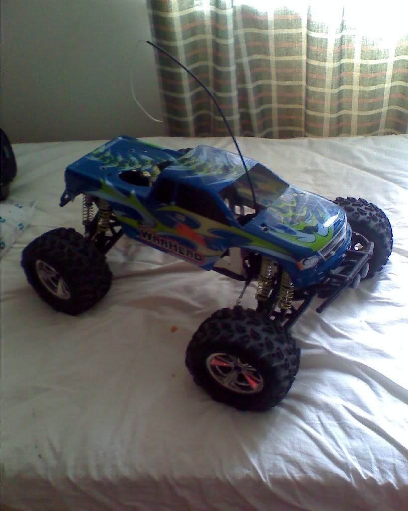

Hey guys, i finally got a new project.. I ended up getting Takedowns warhead :D
He sold it to a guy on RCU and i traded strait across for my raze roller to roller.
Well i plan on Racing the truck at the Jump Jam on August 16th.
Down to Buisness, i plan on using..
-Mamba Max
-5s 4000mah Zippy lipo
-Feigao 8xl-C (finned can)
-Geared 17/44 through an e-savage transmission- Geared for 44-ish
-Badlands MT tires on stock rims
Differential Ratio: 3.3076923076923075
Transmission Ratio: 1.736842105263158
Other Ratio: 1
Spur Tooth Count: 44
Pinion Tooth Count: 17
Total Voltage: 18.5
Motor KV: 2084
Tire Diameter (inches): 5.84
Tire Ballooning (inches): .2
Motor Current Draw: 80
Motor coil Ω: 0.0073
Spur/Pinion Ratio: 2.59 : 1
Total Ratio: 14.86925 : 1
Tire Circumference (inches): 19.6 inches (497.93 mm)
Total Motor Speed: 37336.94 RPM
Vehicle Speed: 46.61 mph (74.88 km/h)
Estimated Adjusted Speed: 44 mph (70 km/h) - 6% loss
Effective KV Value: 2018.21
KT constant: 0.65 oz-in/A
Motor Torque: 0.27 ft-lbs
Final Torque: 4.02 ft-lbs
Final Power: 1480 watts (2 HP)
