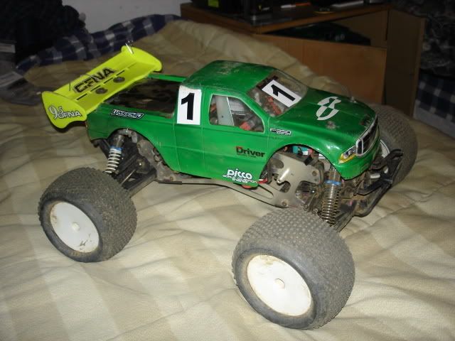

http://i8.photobucket.com/albums/a5/4718/DSC03311.jpg
Aw, there he is.........now prepare for MASSIVE surgery, muwahahaha!

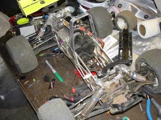

http://i8.photobucket.com/albums/a5/4718/DSC03322.jpg
Oooooh ahhhh........check out the pretty-ful-ness!
