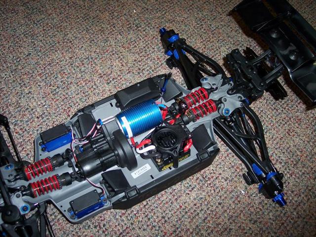

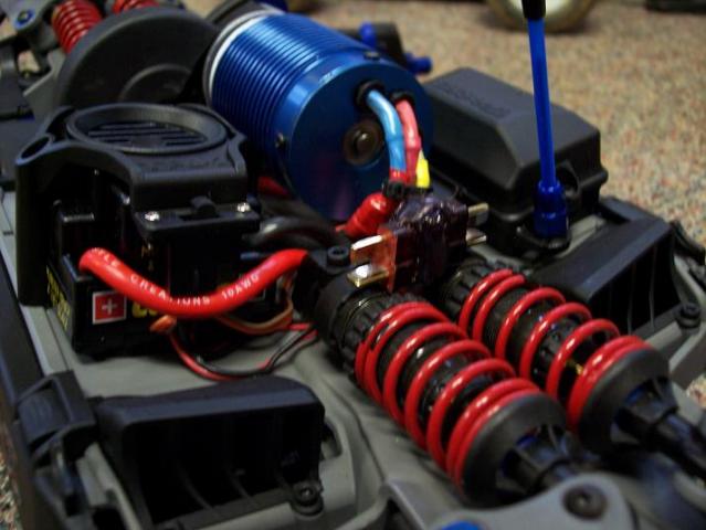

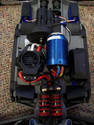

well it started as the brushless edition revo, he wanted a better racing setup so we ditched the castle nue 1515 in favor of a tekno neu 1512 3d 1700kv motor, it will run off a pair of 6s 2500 RC-M lipos in paralell for 6s 5000, tekno swaybars will be installed, along with zero offset bowfighters or holeshots, we are using the monster's setup as a starting point for dailing it in.
i finished the install of the new motor, hid the wires, and made a new dean "T" with the wires snaked under the rear shock mount, the lipo wires will be shortened to where they barely plug in and fit in the tray for some very neat and tight wiring.
