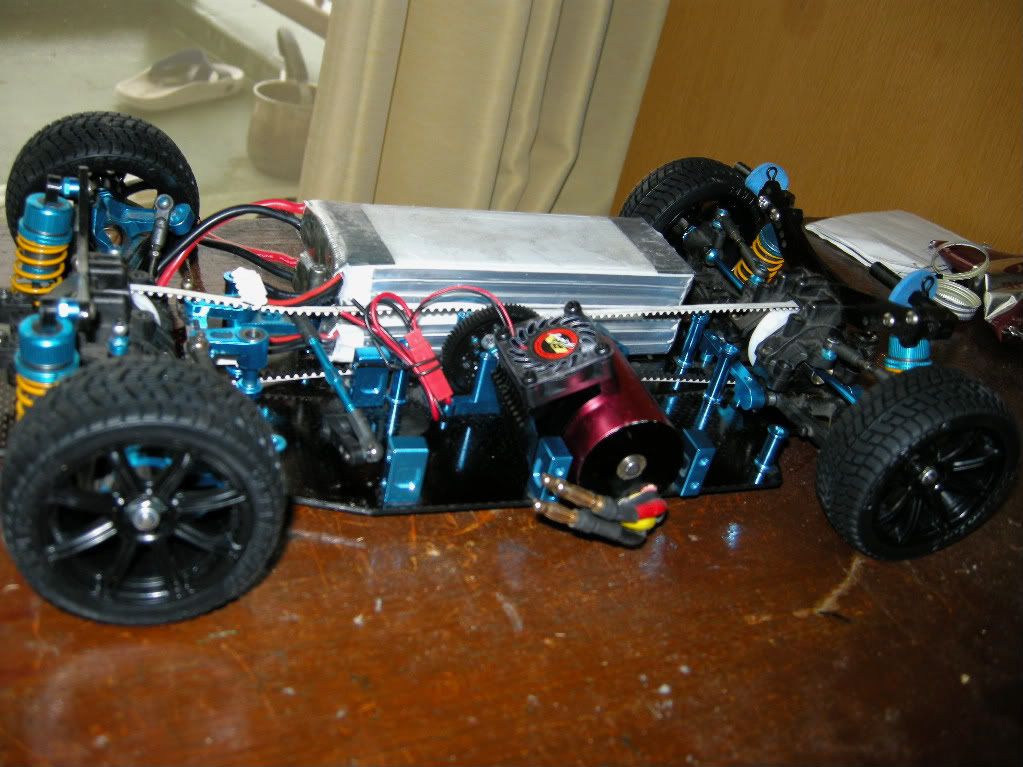

OK mjderstine since you are interested I will post up pictures of the build ...so far its looking like this:

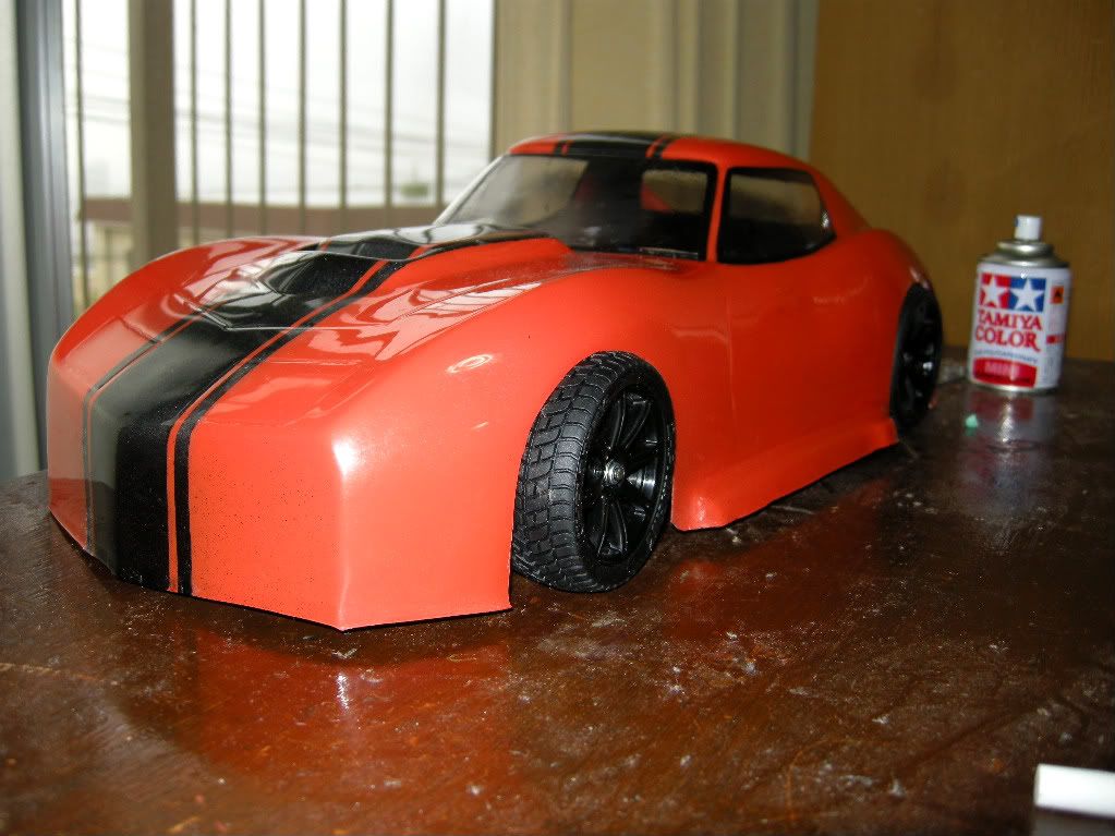

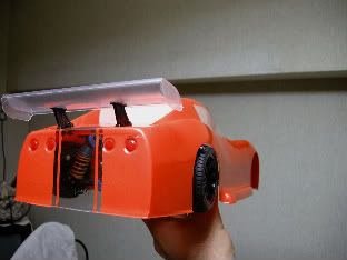

started off with a Corvette Stingray body merely for looks and inspiration through the build ...wing on the back (will go more aerodynamic when I get up to high speeds)
SPUR:75T
PINION: 30T
WAS GOING FOR A TOTAL GEAR RATIO OF :5:1
The car so far

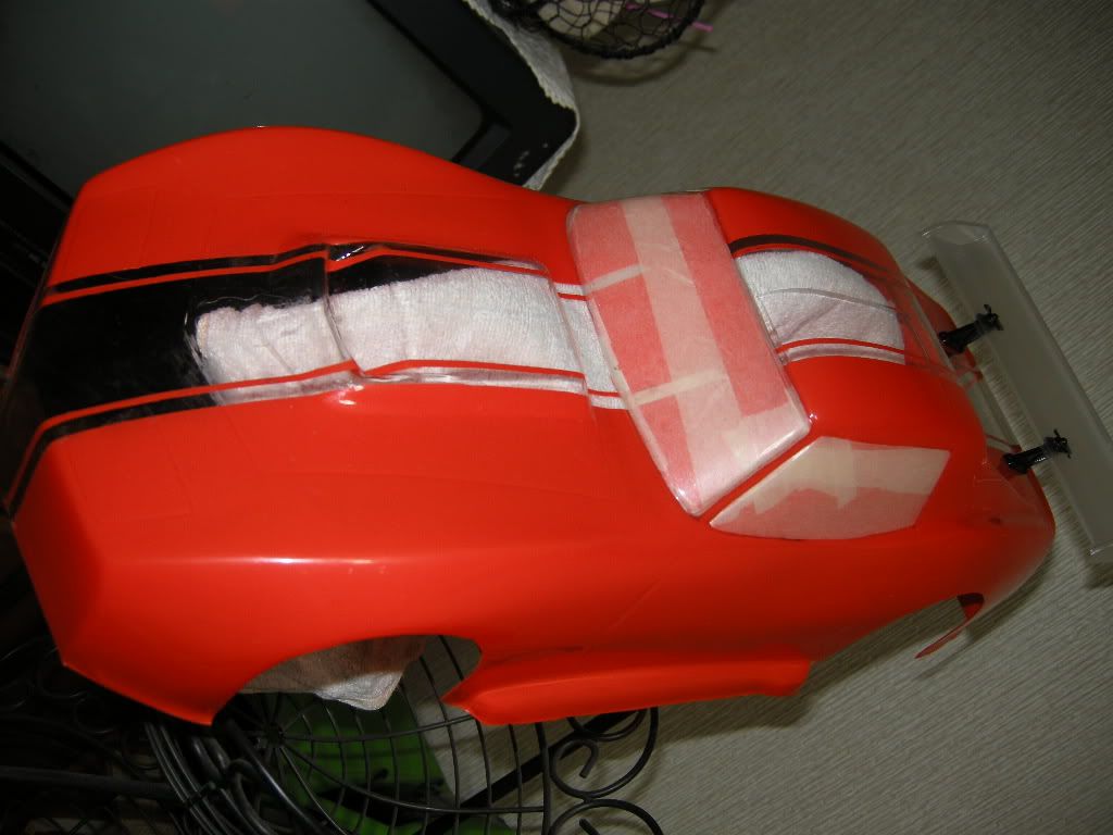

As I said the body is just for looks unless it works well(I will do some testing with some more aerodynamic bodies)
Almost done ..still have to mount up lots off stuff
Have a 100A 1/10 ESC on the way from a Japanese local guy here which we will be testing ...
for the tuning time will start off with a milder setup 4400KV with a CC Sidewinder and safely work up to the 6cells or higher with the lager ESCs that are planed
I am no expert to the high speed thing so lots of trial and error hopefuly not too much of the ERROR bit though...
