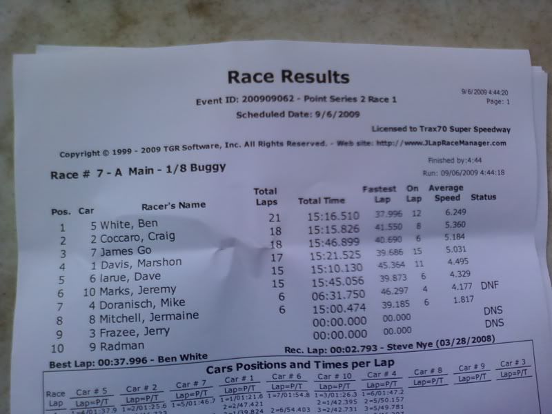

Took the win!!!
started off the day well, had to pick up a set of brand new set of Crime fighters for my 8ight, ran the first qualifier and placed 3rd, my MMM keep shutting down on me...
second qualifier, tried a different battery to aleiviate the problem with the MMM, it intensified- I got a DNF.
before the main I decided to open up my MMM to see if anything visible was out of whack- turns out the fan wires had rubbed through there insulation and the insulation of the circuit board and was shorting the bec.
removed the fan and ran the main, ended up winning without really know I did. My first ever win, hooray brushless.. good thing- my batteries died 2 laps after I finished the race
