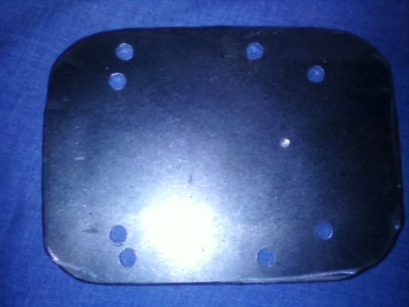

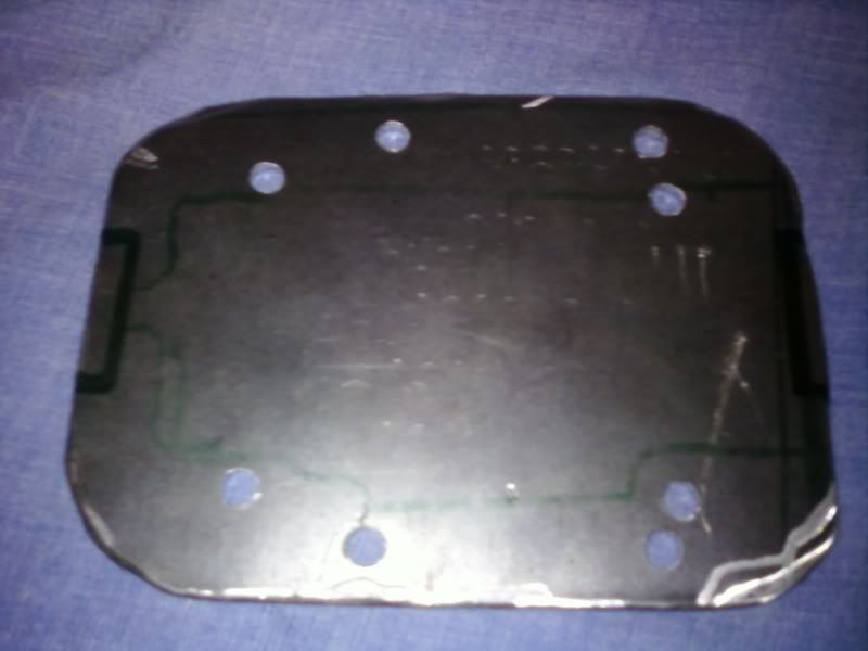

07.22.2009, 09:31 PM
After making a template i finally got a outline!! :)
The holes match up perfect!!!!
So next step, cut along inside line to make hole for tranny to get in
side 1
side 2
