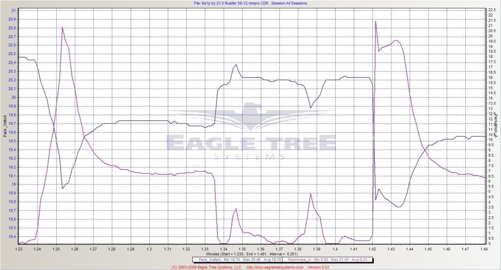

Check out this snipped of the datalog on the setup. A whopping 6.23Amps @ 19.78V average. I'll gear up some more and datalog it again.
