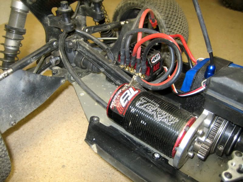

nice.. i was thomking about mounting my ESC there.. that servo mount comes with the motor mount? (mine should be in the mail)

Yes the servo mount comes with the motor mount. I had to drill 1 hole in the mud-guard for the post. No big deal.

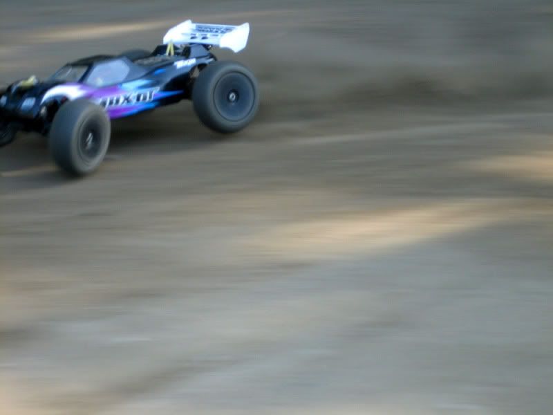

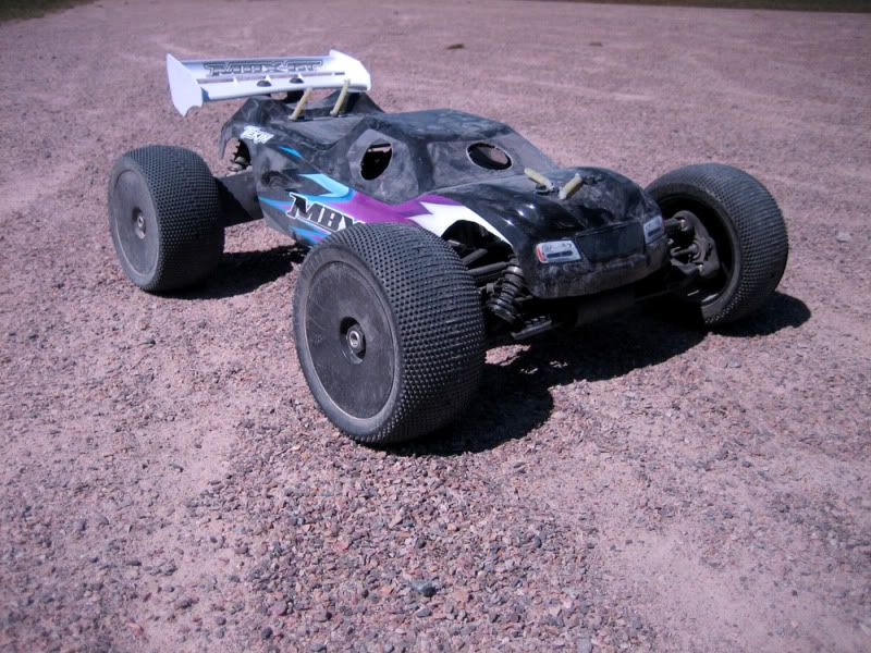

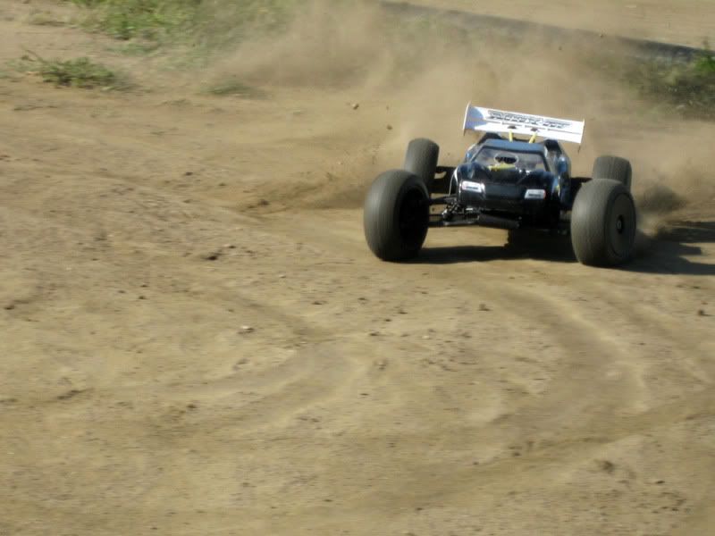

a couple action shots. This thing dominated at the track yesterday. My good friend said it was the best he has ever seen me drive.

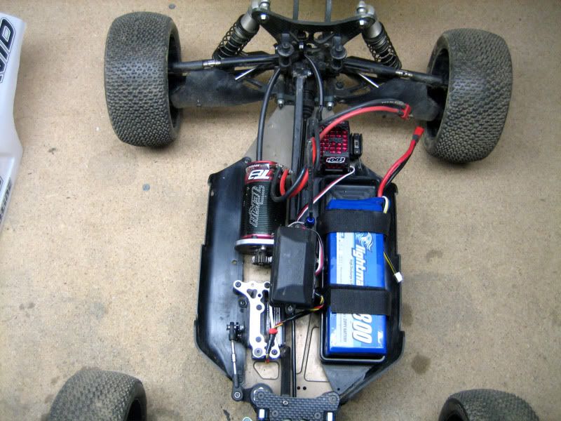

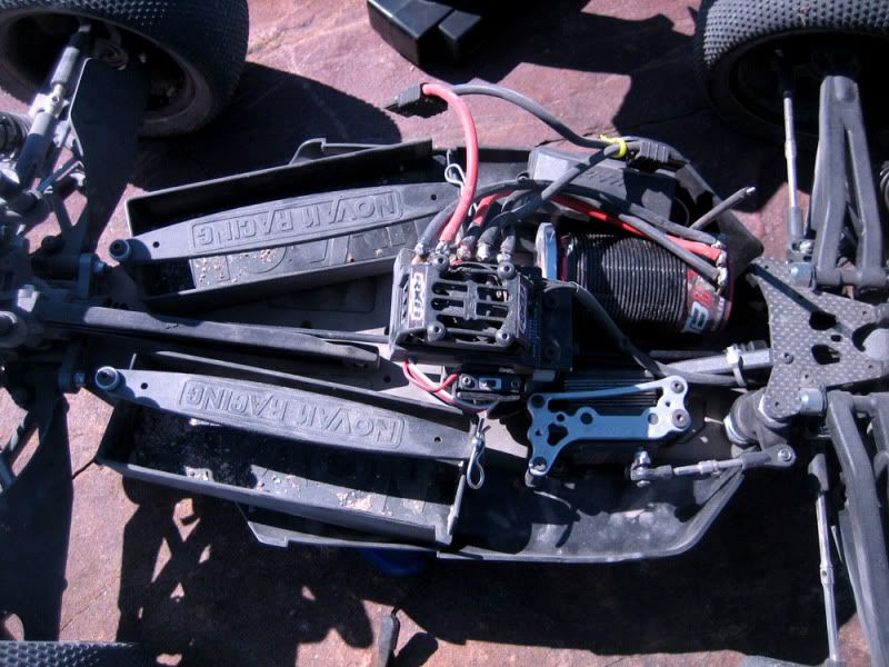

Well, did a complete tear down this winter and decided to switch to a single battery instead of the two battery set-up. Big benefit (charge times are cut in half)
Bought Mike's battery tray, moved my esc to the tray, and soldered up a new set-up. Charged my 5800 4s up and tested in my street.
Initial observations from my previous set-up:
1. The brakes are way smoother now. Not sure if it had anything to do with not having the "reverse motor profile" checked, because now my motor is mounted behind the center diff instead of infront when I was doing 2 batteries. Literally at full throttle and my brakes set at 40%, the trug slows down like warm butter. Sweet.
2. Decided to gear down 1 tooth, so now I am running 15/46 (35mph). Supper punchy, so I set my Current Limiter to 40, and the timing down to 0.
So I hit the track to time the runtime of the 4s 5800 (no pics yet, track was very, very rough after winter).
The balance is very, very nice. Flies through the air like an arrow. Lands our huge double without a thud. The Revolvers are probably hands down the best tires I have ever drove. They hook up like velco.
I ran hard throttle heavy consistent laps for 15 minutes before a tire bead blew.... I am hoping to get 16-17 minutes out of these 5800s. I have seen a lot of threads recently about runtimes... Basically the missing factor in alot of these questions are, MAKE YOUR TRUCK LIGHT AND FRICTION FREE. I can roll my truggy on the basement floor and it rolls with no resistance. Kids need to make sure NOTHING IS BINDING, your bearings are smooth, nothing is rubbing against any cvds, your diffs are perfectly shimmed and meshed. This will make the motor and esc very happy and cool, which in turn, produces longer runtimes.

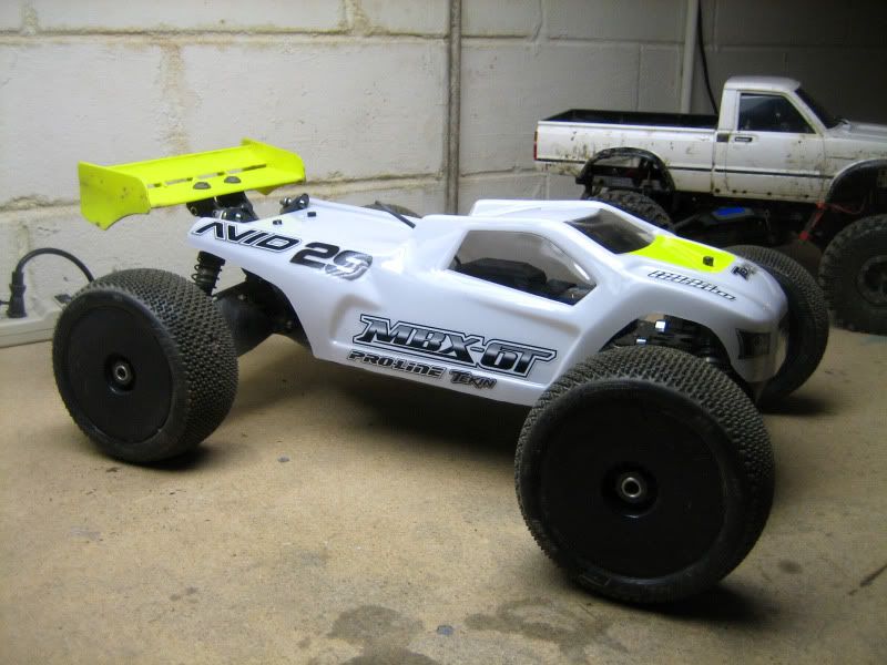

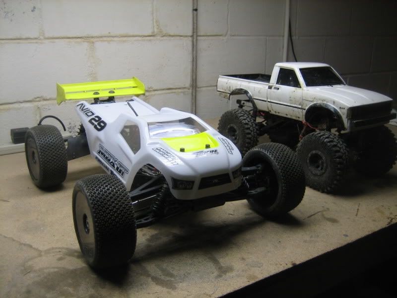

Here's some picks of the new lid. Decided to go mod and simple. When 5-6 truggies are running at our track, I need to see mine, so painted it white.
New chassis set-up. Real clean:

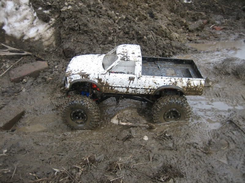

This is what else I have been up too. Getting way into scale-trail!
