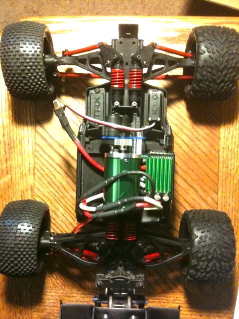

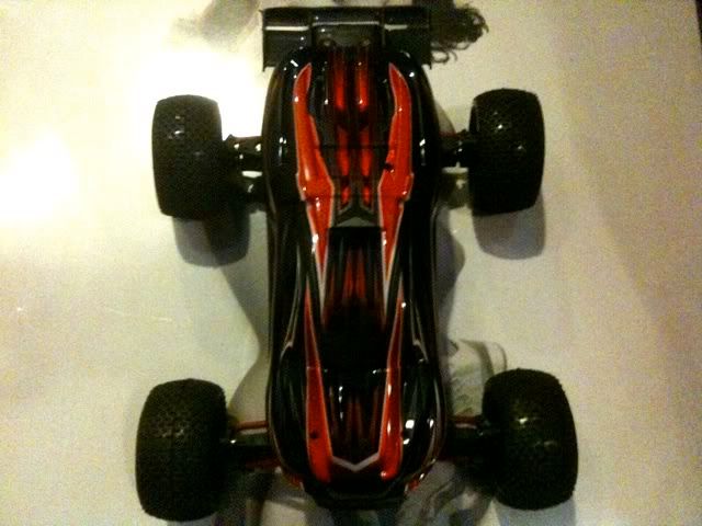

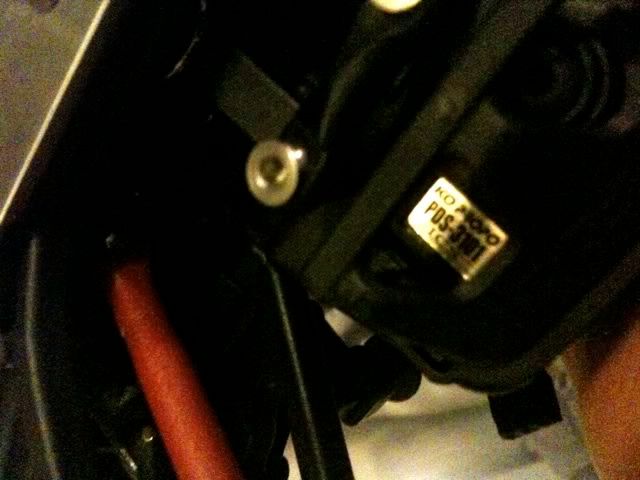

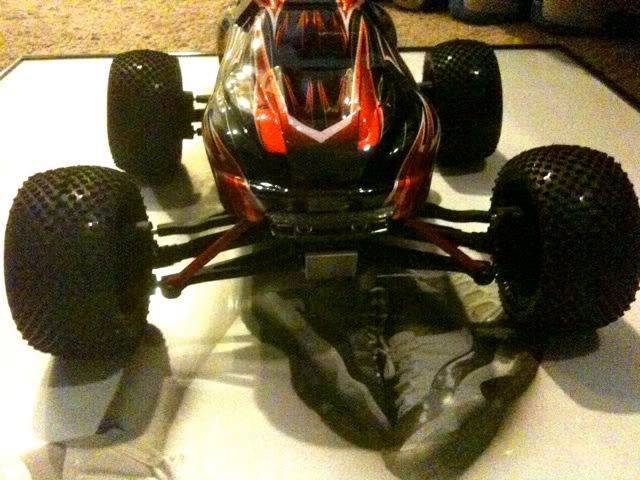

Serious? You guys never seen the Tenbol mount and a MM ESC before?
Here's a top view:

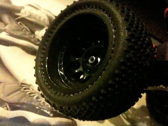

Stock rims on the right... the left is the extended wheel/tire combo that adds about 2 inches to the width. I dont have the mini until I get home

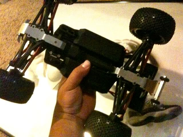

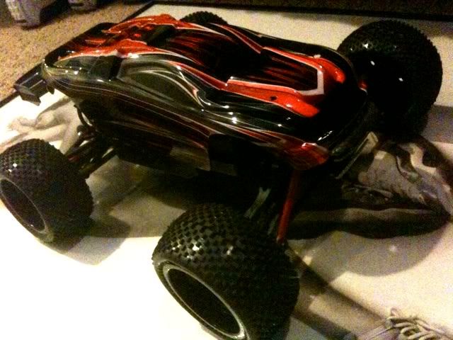

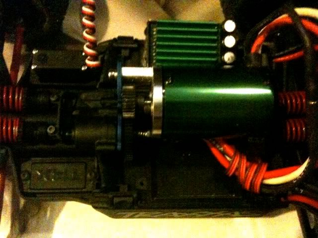

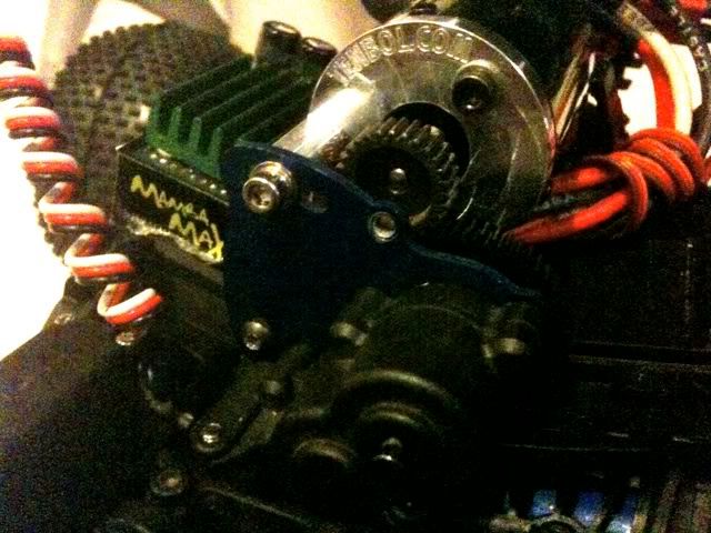

Ok.. Make sure to hold it when you take the pictures.
LiqrSicc
LiqrSicc's Avatar
Posts: 178
Join Date: Apr 2009
Location: NorCal
08.12.2009, 12:16 AM
OK here you go:
Having a major cogging problem even after dropping down to 55/28. Not good. I'm starting to think I have a bad ESC. I want to play with it more and make some adjustments but 100f weather is here until the weekend.
