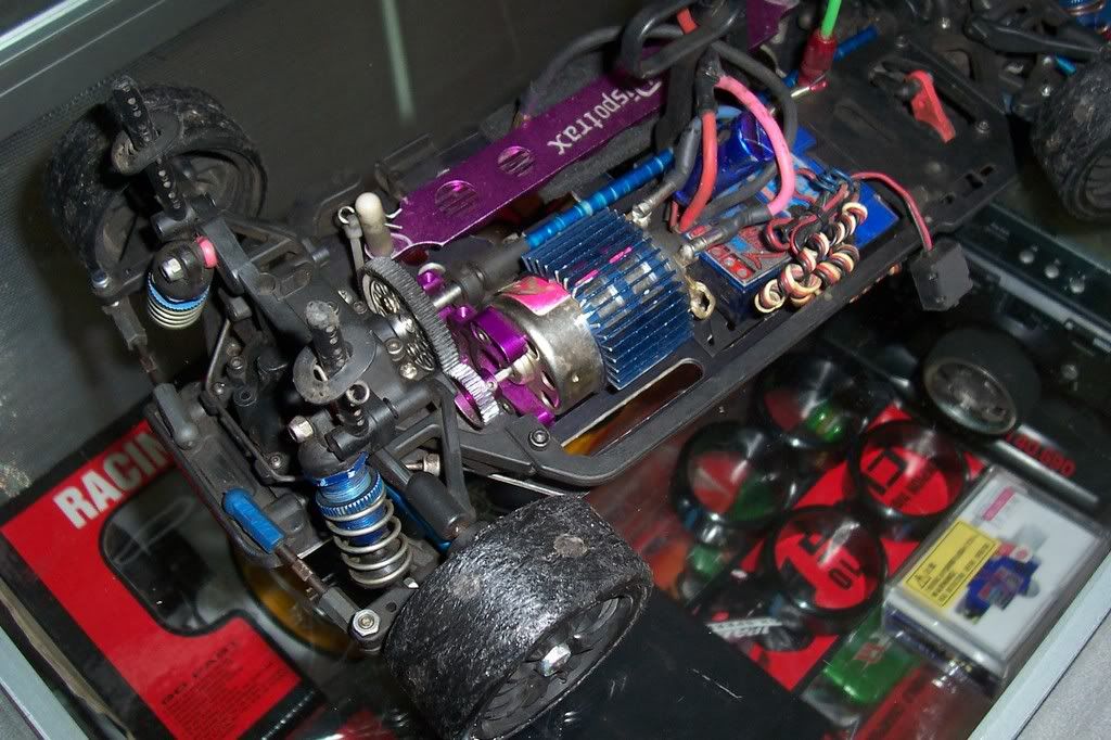

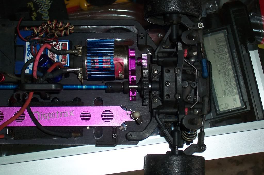

I've seen a few jato's converted using the revo mount, does make for a pretty clean setup. I found these pics, but the thread is couple years old, and the poster hasn't been logged in for over a year. Looks like something made for the application.

I don't think those motor mounts are made specifically for converting the NTC3. Most of those look like the person used motor mounts from some other electric TC's and drilled the chassis out to make mounting holes for them. Shouldn't be too difficult to do, just need to figure out which motor mount will be a good fit.
