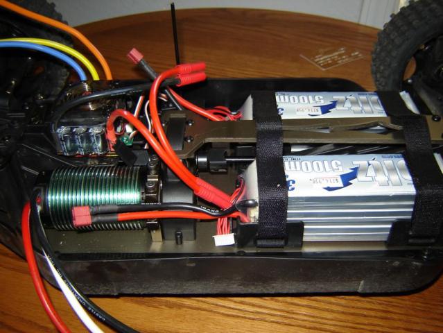

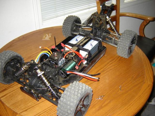

I've got one with a CC1520, stock ESC and an upgraded steering servo (Hitec 5645) with a sportbec bec to power it. I love it. Baja wheel adaptors are available, making all wheel options there available. Also, some FG wheels and other 1/5 scale brands that use the square adaptor will work as a direct fit.
Handles great. Plenty fast and jumps like an 1/8-scale buggy.
Sorry, pics posted are of another guys ride. I posted via phone by accident and used the wrong images..

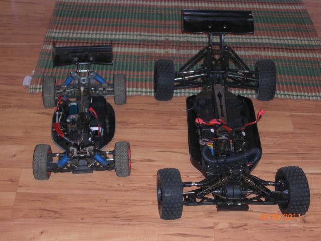

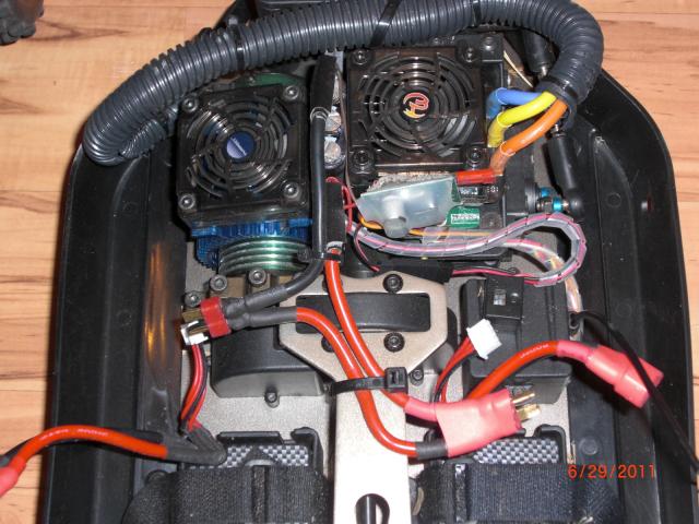

Here's my car, next to my converted Hyper 8:

Thanks killajb, you've got a heat sink + fan, does the 1520 get hot?

I have a 1717 as well, and started out with it in there. But I've found that the 1520 runs cooler and seems more suited in my ride. Heatsink and fan were items I had already and installed just-in-case. Can't really hurt.
