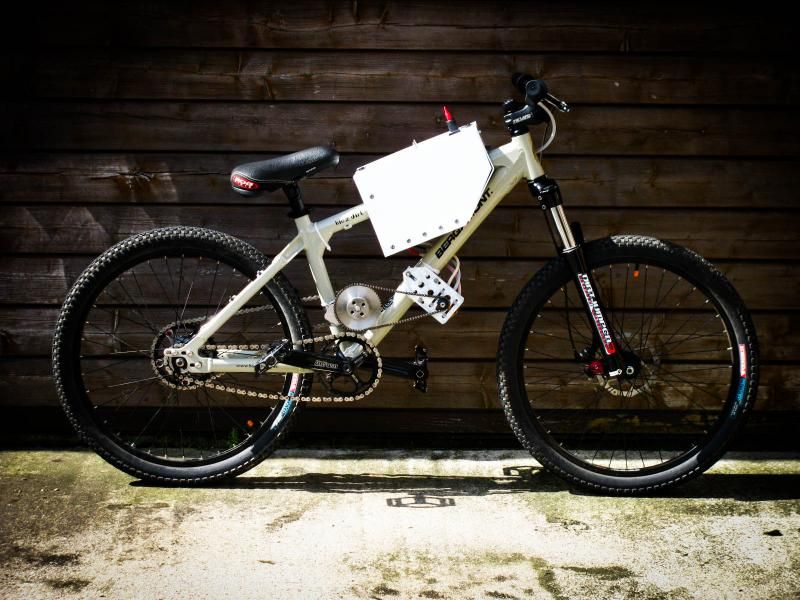

I'm not very active on this forum anymore, that's because my interest in RC-cars are mostly lost. However, I'm doing E-bike's now. Thought I would share this build on here... :)

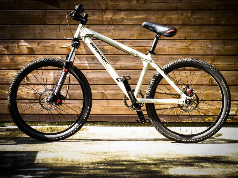

Bergamont Lithium Polymer

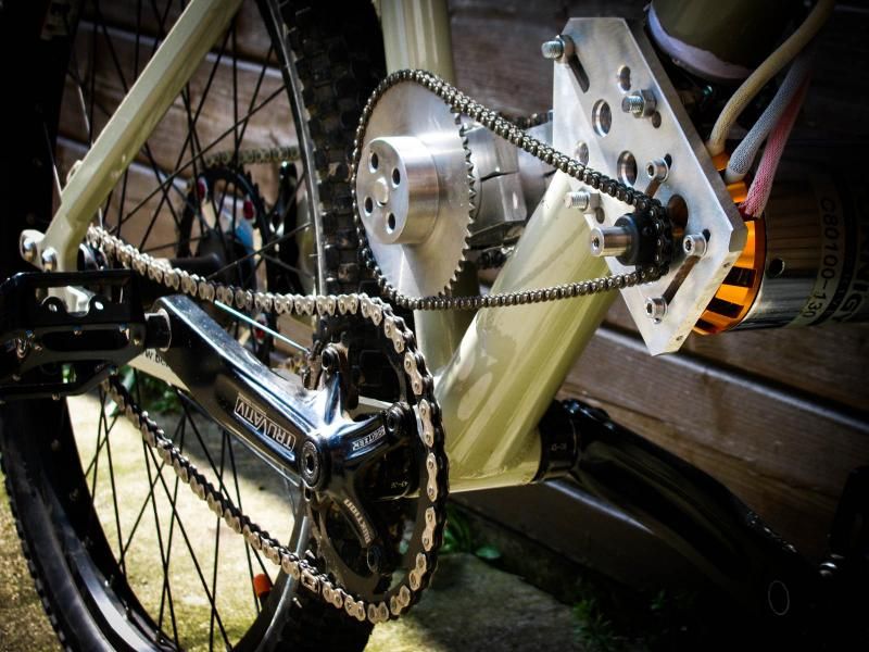

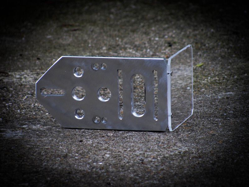

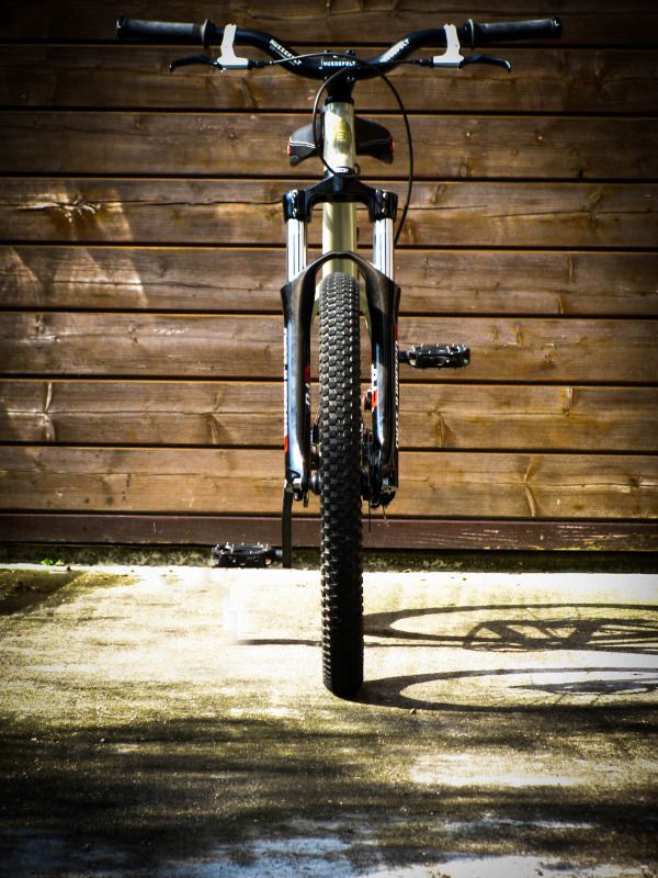

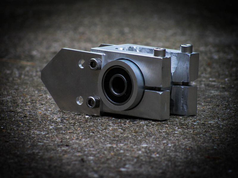

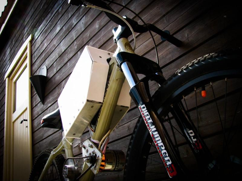

This is my second E-Bike. The main points of this bike are: lightweight and durable but still have a good amount of power. I bought this bike specifically for E-conversion, it weighs 14.9kg's stock. The motor that will be used is a brushless Turnigy 80-100 130kV in combination with a Castle Creations 160HV running on 10S2P LiPo. It is a left side driven bike, that means there will be no rear brake.
I'm busy with school (1st year mechanical engineering), so progress goes slow.

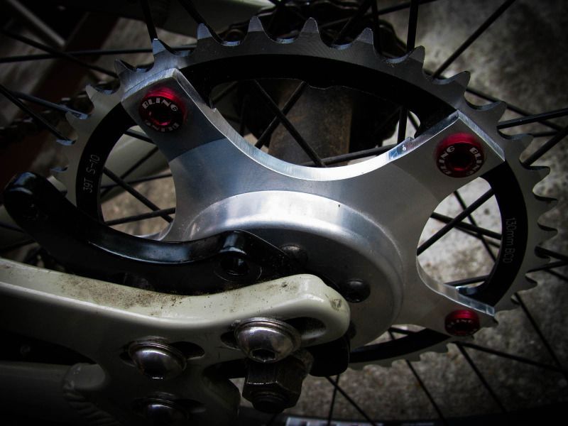

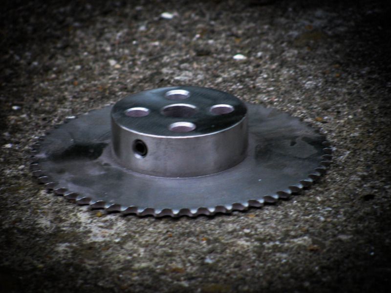

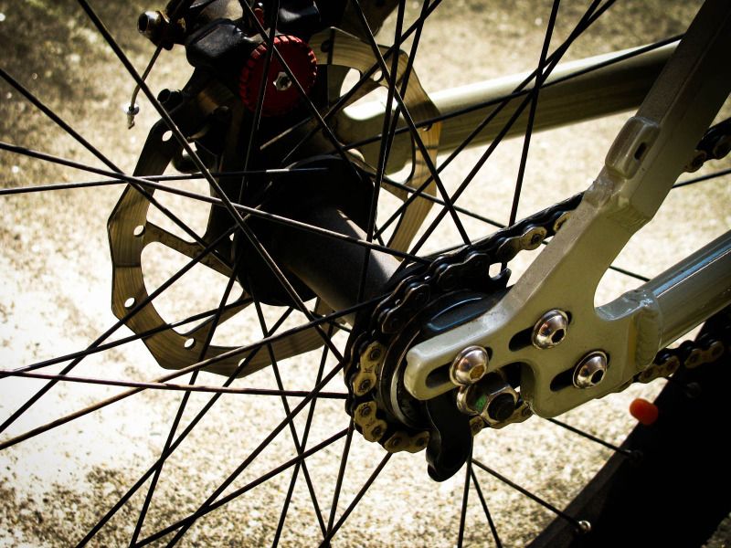

Removed the rear brake and added a 39 tooth FSA chainring bolted on a 130mm adapter...

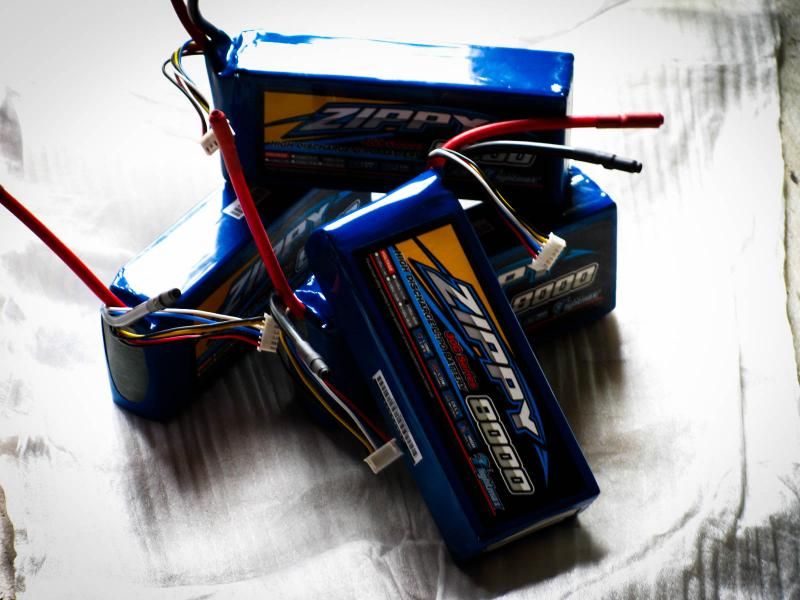

In the meantime, my 2-year old LiPo packs had bad cells, so bought new ones! 8000mAh 5S * 4. These pictures are from the (almost) finished bike. I will be doing testruns, as I've got some minor chain issues.
Again, progress is slow, but I will update it when I've sorted out the chain alignment issues.

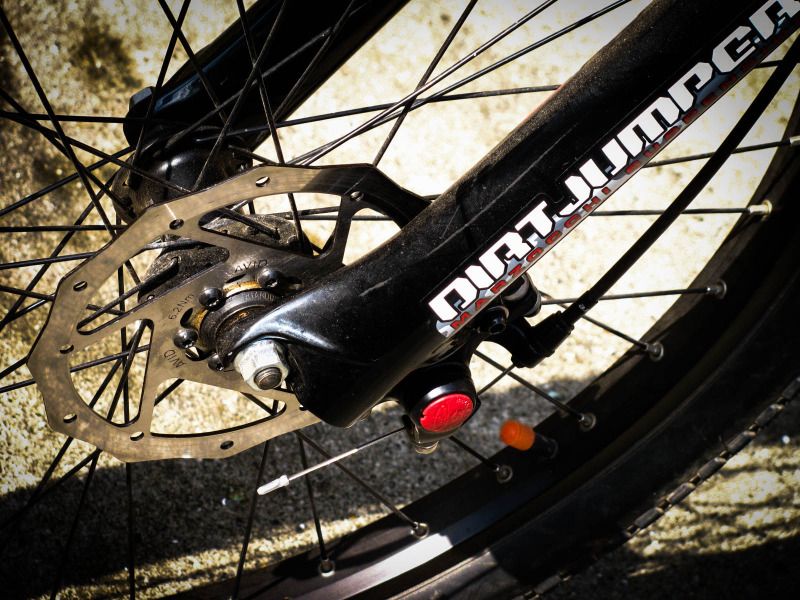

Nice conversion man. Looks like your could still install a rear disk brake though. Or is there zero space left?
Yup, a 203mm rotor would be possible. I might buy 2 * 203mm rotors in the future, but will first try only one break.

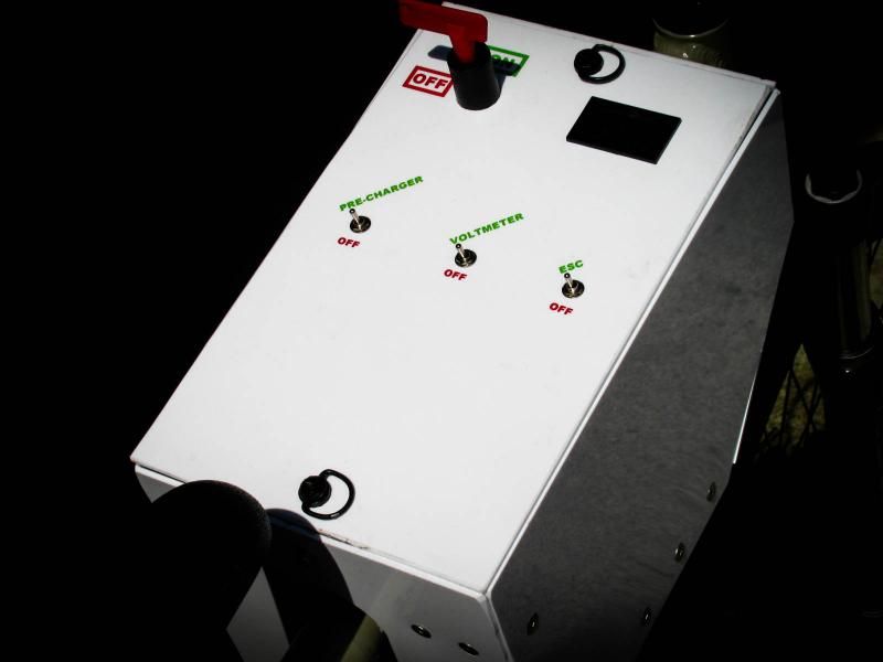

Byte my dutch friend, this bike looks quite fantastic! I LOVE the battey/controller box, looks like a stealth ebike. NICE work.
