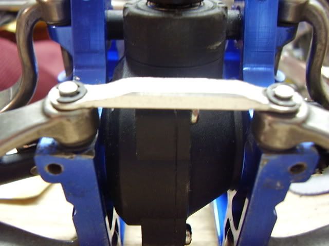

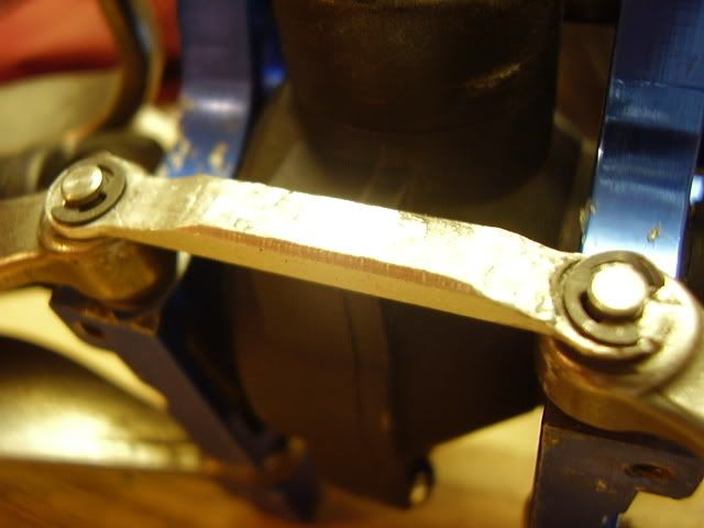

I know this has been on here, but figured I would make a post dedicated to it. It has worked wonderfully for me, except loosing a e-clip every once in a while. And I just pulled my front end apart so I figured I would take better pics.
I found this brace on EBAY, is says its for the rear as a pin brace. But it will also work on the front. All you have to do is grind the ends down enough to be able to put the e-clips on and clear the steering bellcrank. Easy to do with a grinder, or dremel. I was bending front lower pins almost every run, I havent had to replace one since I put this brace on.
Good Luck and hope this will help someone!:027:
For some reason I cant get the pics to show, you will have to click the links.
