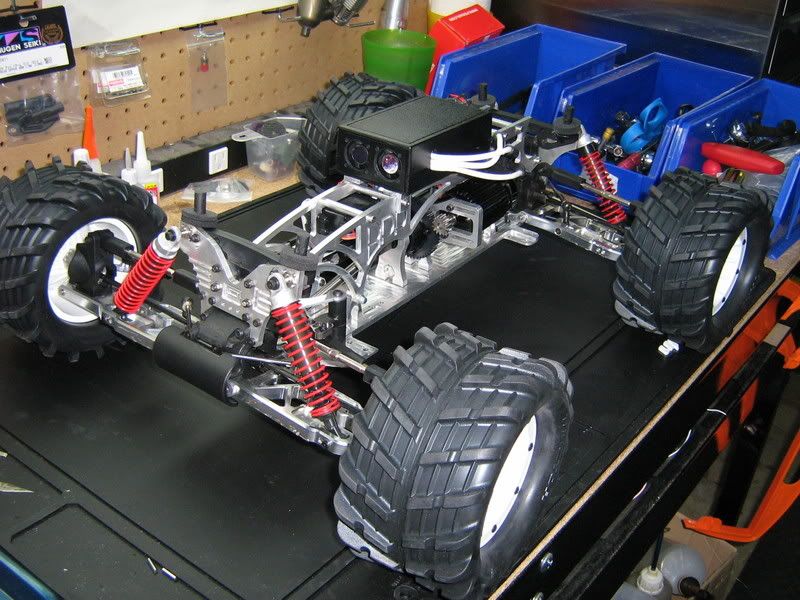

Well here is my new baby I have been working on for the last month. I got my BPP chassis a couple weeks after squee got his. Here is what she has

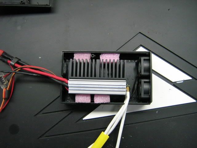

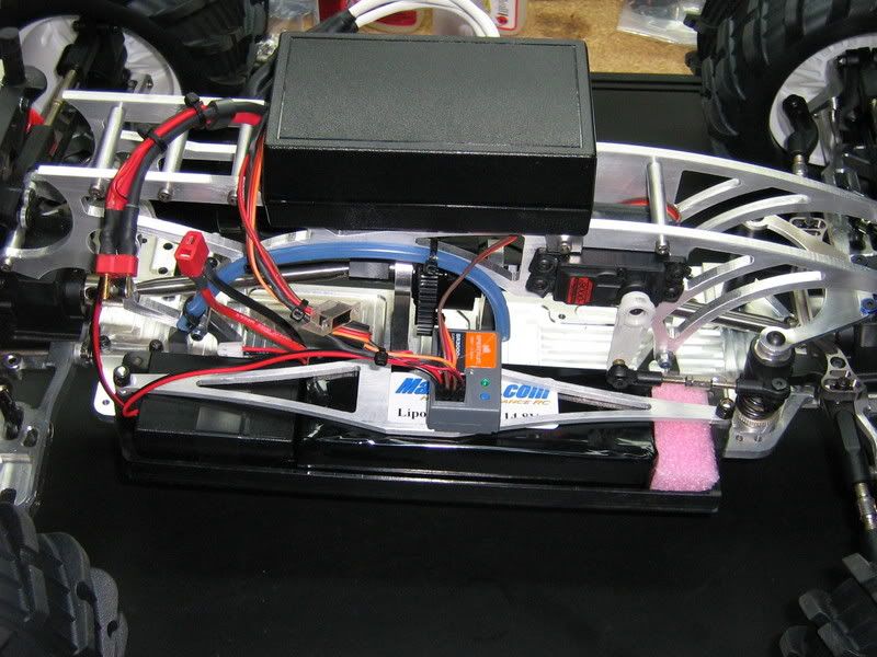

Quark 125b, Feigao 7XL, 14/52 gears, Maxxamps 4000mah 4s packs, maximizer beadlocks with tractor tires, JR 9000T steering servo, esc box with novak cooling fans, UBEC, and some HPI Savage bits here and there. One of Mike's motor clamps is soon to be installed along with the second battery pack. I'm still looking for a good location to mount the esc box, one bad flip and that thing is toast. I'll also clean up the wiring later.

I don't really get the huge esc box though.

The big ESC box...well I couldn't see a secure way of mounting it. I normally see the ESC zip tied down on other members rides, but the BPP chassis is curved up top. Can you suggest a better way to mount it?

I mounted my 7020 under the 3 braces in the back with zipties....Nice truck! I thought that Jeremy from BPP sold that truck...It was on Ebay, right? Jeremy sold his right after I bought mine. I was practically brand new and only used for 1 race day I think.

I think I will retry mounting the quark in that same position but without the fans. Cut the heatsinks so they slot between the cross braces. Hmmm you got me thinking now.

it looks promising..but I think you esc box mounted to high personally....even with the body on...it doesn't look like it is well protected

I agree with you all on the ESC box being mounted too high. I'm going with squee's setup underneath the three rear cross bars. I'm going to trim the heatsink a little to squeeze it and the fans under there and completely forget about the outer housing.

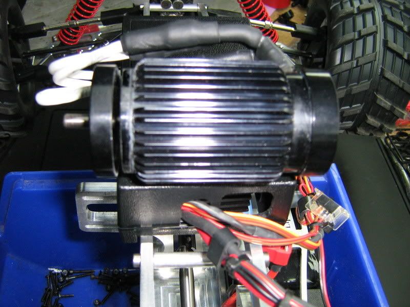

Good news though...wife called and said I got a package from NY. Looks like my motor clamp came in. Thanks Mike! I forgot to add that the reason why I had to get the motor clamp was because the front cover on the feigao fell off during the first 90 seconds that I ran it.

I don't think it will work with the Feigao C motors...By the way, when you ordered the 22* front hubs, did you get the package of screws and ball ends? You need the ball ends with the holder on them to run the 22* hubs.

your motor looks like it could use some rear support toward the back of the can...and I'm not sure if the motor clamp will fit the feigo as well....

Well that puts me in a bit of a predicament. I ordered the XL mount, so shouldn't I be good on length? Diameter I can understand there might be a problem, since the heatsink case on the feigao makes it larger. A rear support would make a lot of sense. I'll have to wait and see what the clamp looks like and go from there.
