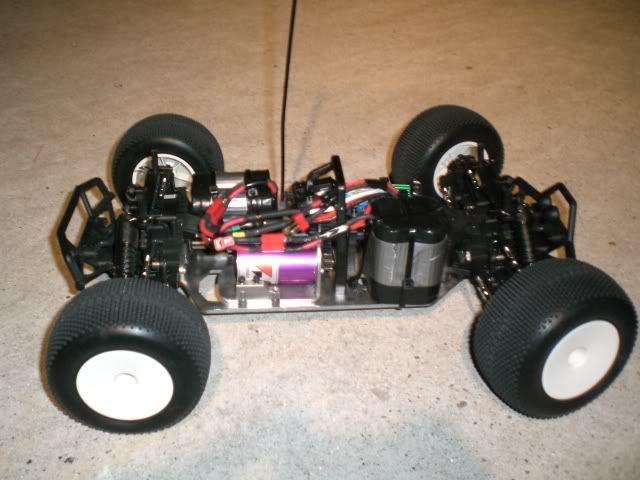

finially got my lightning stadium 10 done
tashpop
Posts: 641
finially got my lightning stadium 10 done - 11.08.2007, 09:43 PM
mm esc
ccbec
feigao 10L
4s1p X2 A123
stupid early dark hasn't let me drive it really yet, but from running under the driveway lights, its going to be sweet
i have a rc monster heatsink clamp on order, and the only thing left is watching out for balance. if it seems off a little, i'll remove the handle so i can lay the forward battery pack down on its side. if it is still a little off, i'll look into flipping around the motor and having both packs on the rear.

i'm not sure yet. i just got a good motor today, first one was doa. with the time changed back to normal, its dark when i get home from work. i did punch it in the living room on carpet(max tire traction) and it literly flew upside down and lawn darted the rearend into my couch about 5ft away. i didn't hear any gear strain with that, or the 5 or 6 times afterwards.

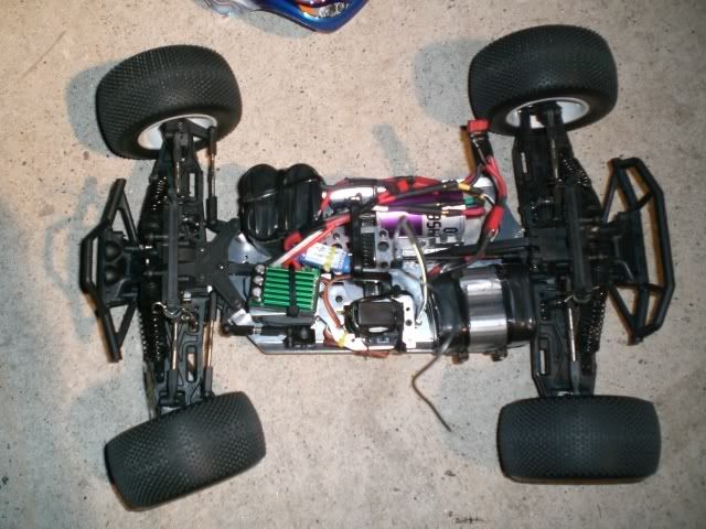

Its actually a great handeling little truck IMO. Your looks nice. Good job. I am running motor front opposite the servo and the 2 packs in the rear. Do you have any closer pictures of your motor mount. I cant quite make out how you did yours. Mine is just a piece of L aluminum screwed to the chassis.
i don't have any closer pics, but i made an L bracket and notched it where the stock nitro motor mount screws went through the chassie. i then used the stock nitro mounts to clamp down my mount. i did this because i was in a hurry and its what i had. the nice thing about it is the the mounts because they stick up, also sandwhich the motor inplace.
wait, maybe you can get a better idea from my first pic i posted in another thread.

holy cow, you got that off of your 4s packs? did the temp seem happy with your gearing? i still haven't had a chance to open mine up, but tomorrow morning its on. i did jump my ditch once when i got home and it landed upside down. i was running with the body off because i'm still feeling things out, and i sheared one of the front body mounts. it looks like i have to replace the whole shock tower, am i just looking at it wrong? i didn't really check it out too closely.
tashpop
Posts: 641
12.09.2007, 10:10 PM
just an update. the truck is awsome. i needed to bring the gearing up a bit, but since i needed to replace the stock tires, i just got some mashers and killed two birds with one stone. that did alot for this truck. it has proven to be very tuff for a while now, until recently. i accidently discovered that from a dead stop to around 5-7mph and deep throtle jab will yeild a complete flip over back onto the tires consistanly with every attempt. being the first truck i had that would do this, i kept on doing it over and over. eventually, i got a striped wheel and hex, and bent rear dogbone out of the deal. also the slipper seems to have loosed up alot and isn't powering the front drive axle at all. but the good news is the diffs are holding. i thought they would be the first to give. i'm going to try to get a vid if i can get one out of my digital camera. i never tried to figure out video on it.
