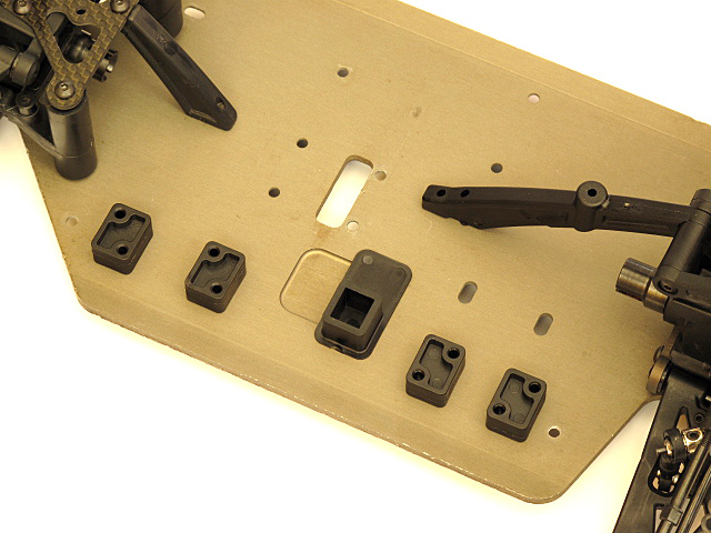

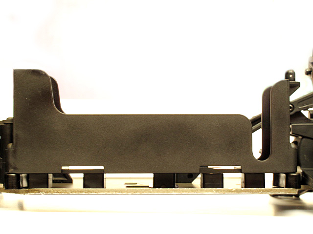

The parts definitely fit. Whats more those extra parts from the 40946 Batt tray moulding are actually to fit the conversion directly to an Ofna CRT.5 Extended chassis with no drilling required!
Clever, BUT... it raises the whole battery by about 7mm which will adversely affect COG.

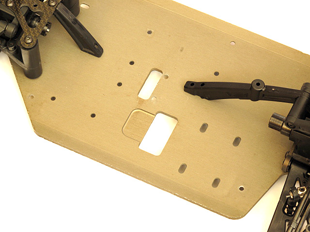

I was planning on mounting the batt tray straight to the chassis as per SCRT-10. There may be JUST enough room to drill the outside holes? see pics

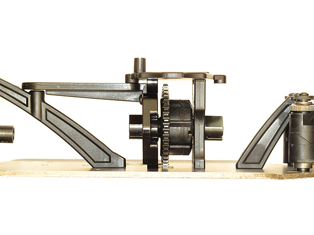

The rear brace is indeed to fit the CRT.5. And the parts go together well for a tidy layout.

Anyway, check out the pics. Parts are just sitting there for a rough fit at the moment.

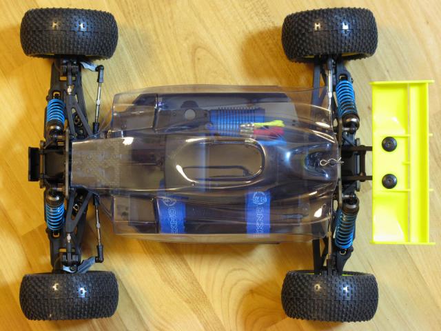

02.03.2010, 04:40 AM
Finally got it back together. Just waiting on the MMP now!
All went together smoothly. Just bolts together.
Mounted the battery tray on the chassis though. And also some Tekno mudgaurds.
I'll post some details soon.
Cheers.
