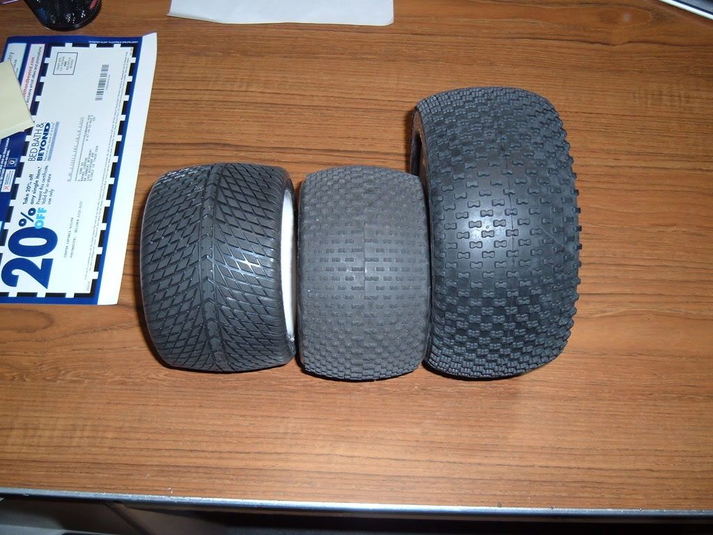

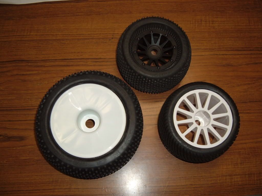

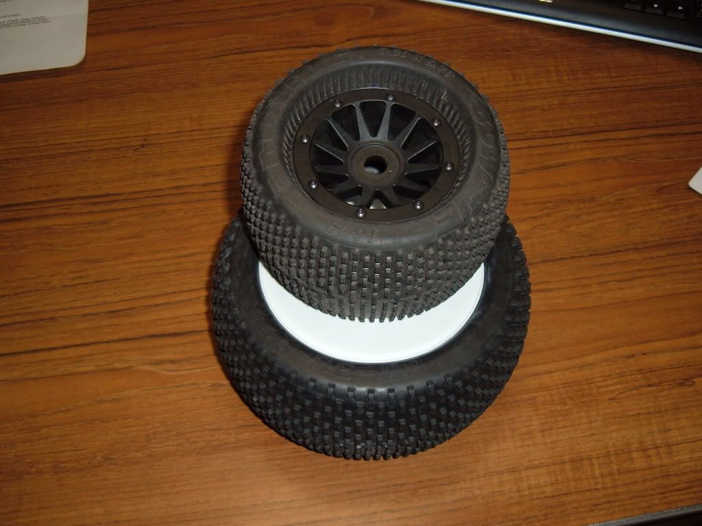

Ok, so I decided to put the big Cen wheels/tires on my savage with the RCM tranny forward chassis. I took some pics with other tires, and weighed each one so that we have some sort of comparison.
Stock HPI wheel/tire combo from a savage ss kit (billed as lightweight): 214.6 grams
Maximizer beadlock wheel, with proline bowtie tire: 297.8 grams
40 series spoke wheel with road rage tire: 292.7 grams
Cen Nemesis white dish wheel with "bowtie" tread tire: 434.1 grams
So the Cen setup is twice as heavy as the stock hpi stuff! Nice to see that the hpi combo is considerably lighter than the others in the same size. Might be a good reace combo? or a least a lightweight tire.
Now for the pics:

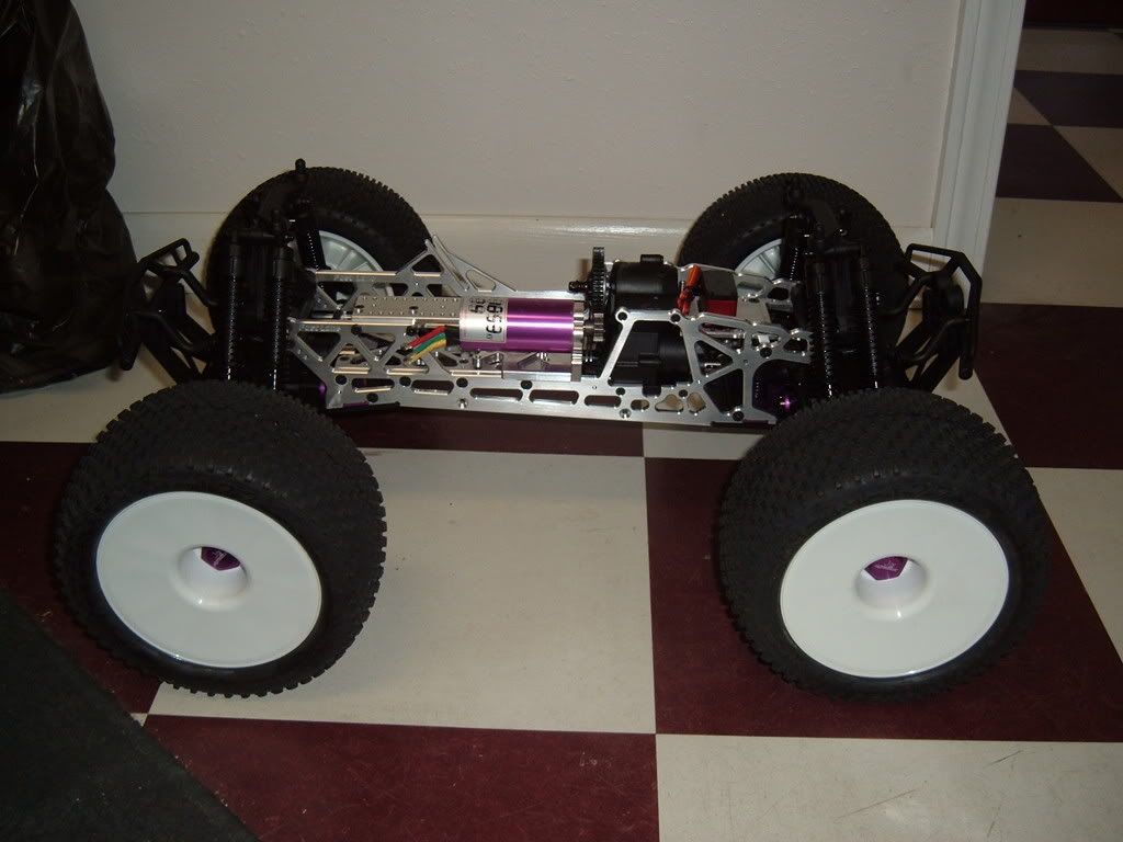

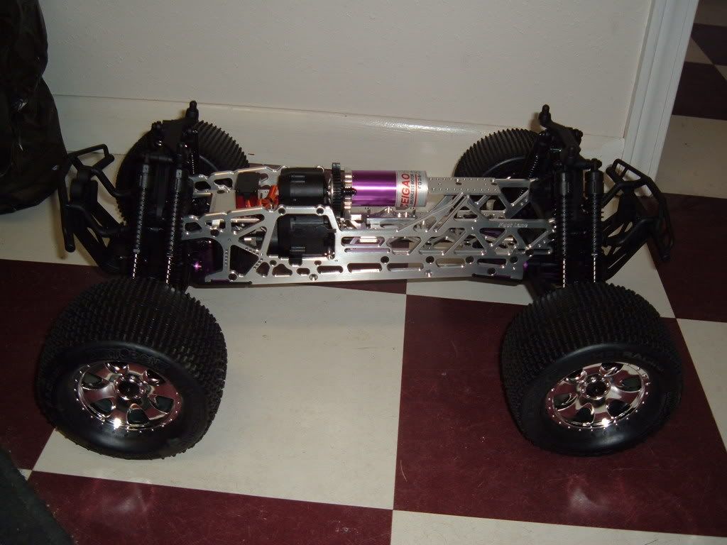

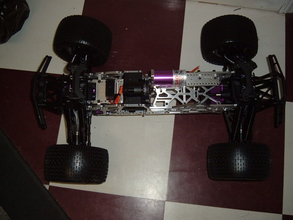

And a few before and after shots on the savage. Power system will be an Aveox 1300 kv motor on 8s lipo thru a cc hv85 esc.

hi
i have to say it looks nice on such a long chassis. maybe the extended flm a-arms would look great too on this beast.
the heavy tires will be tough to the diffs though.
bye
rhylsadar

Much better. I think with the FLM extended a-arms and the chassis maybe 1 inch longer, it would be absolutely perfect.

let's take a look at pic #2, you'll notice lincpimp is a valued customer at bed bath & beyond, he gets discount mailers sent to him, and unabashedly leaves them in his r/c pics. Perhaps lincpimp is a well moisturized and exfoliated member of the r/c community, is the wife just for appearances lincpimp?????
