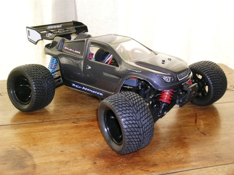

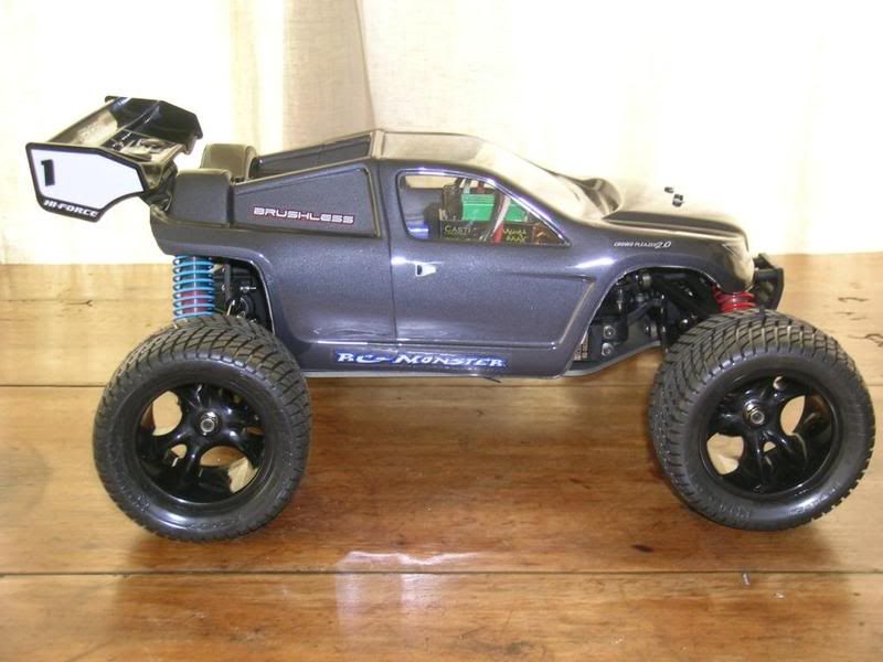

Today I finally ended my CRT.5 conversion.
I bought an upgraded brand new roller to strodedawg (thanks again Jim).

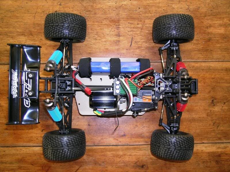

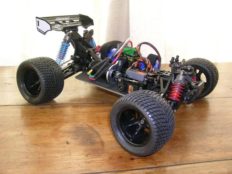

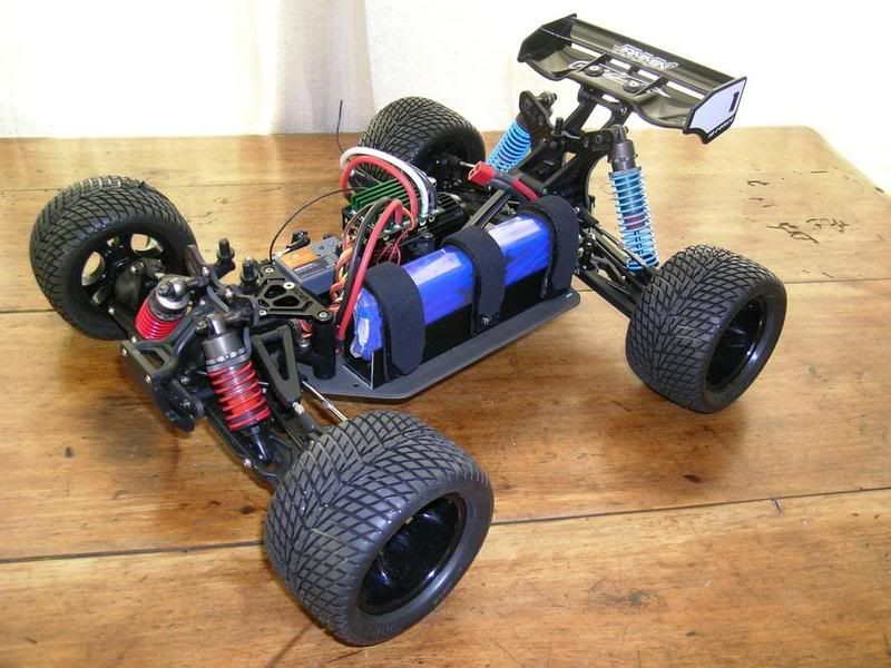

I added the electronics: and Road rage tires:
-Mamba Maxx ESc
-Feigao 380C 6L
-Hitec 5625MG servo-
-Hyperion 3800mA, 3s, 20C lipos.

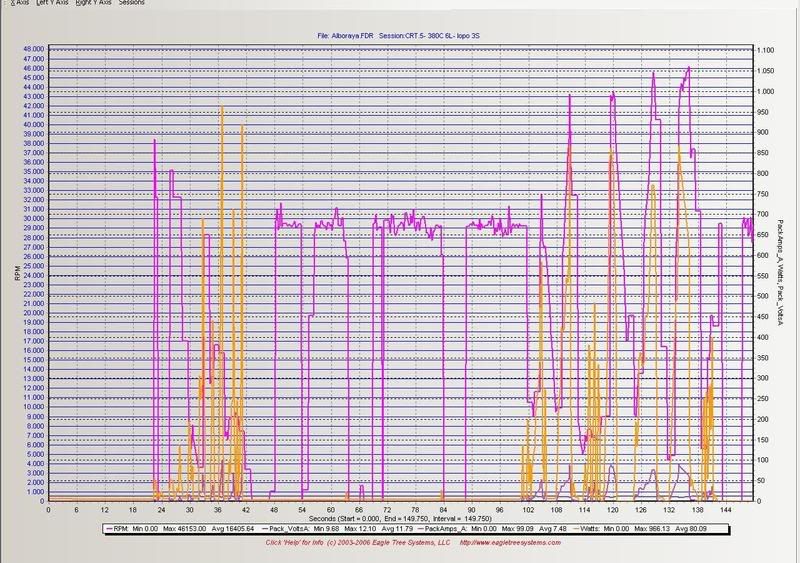

I ran it today and was greatly surprised: wheelys on demand and a top speed of 45mph. The eagletree shows peaks of 99A and 966W during the speedruns. The RPM in the air 54000 and 46150 on road. The weight is 2300gr RTR and 12/46 gears. The tires are 2.2 Road rages on clawz wide wheelbase rims.
Here are some pics, hope you like it:
