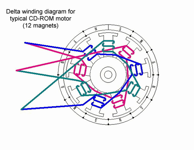

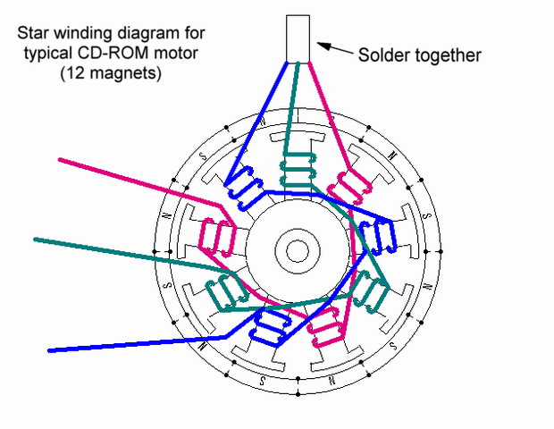

Here is a very simplistic picture that gets to the point on how they are wired internally
ID:	4265   Click image for larger version
