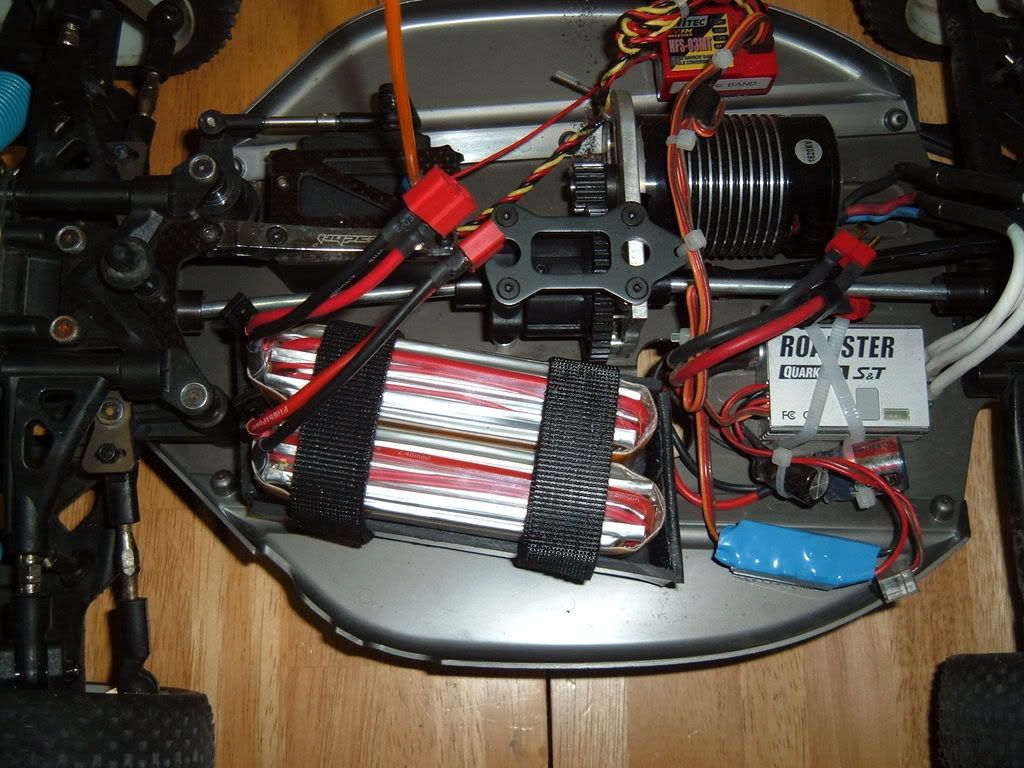

Ok, I like to have the battery as far forward on the gas tank/engine side as possible. You can most likely make a combo tray that will work with both batteries that you have. I would make a tray that will fit the proteck pack well, and mount the MMM behind the battery. Something that looks like my hyper8:
I like to make my own trays, so I would make seperate trays for each battery type. I usually make a riser out of al, that I can mount to the chassis using existing holes (I do not like to drill any holes in the chassis). Then I tap holes in those risers to mount the tray from the top. So I only have to remove 4 easy to get to screws to remove the trays, and I can leave the risers in place.
Seems to work so far. As shown in the above pic, I canted the tray towards the center at the front, in an effort to get the weight as close to the center as possible. I am going to do something similar to my hyper st.

The first picture gets my vote. A single battery on one side and everything else on the other is ideal for weight balance most times(depends on the battery - sometime the esc can live with the battery). A single battery will always get my vote - half the charge time to worry about, and usually easier to balance and install. You can also adjust front/rear balance very easily by simply moving the battery foreward or rearward as needed. :)

Thanks for feedback - I went with Option 1 with standard polquest tray - It fits the protek well - maybe .5" long but easily dealt with a spacer. It will allow me to run a 4s pack while the MMM is away.
The ESC mounted up perfectly behind the tray - I used one on the motor mounts and some CF to create a little riser so ESC not on the chassis (Helps in case I hit water)...
Happy with the results...
