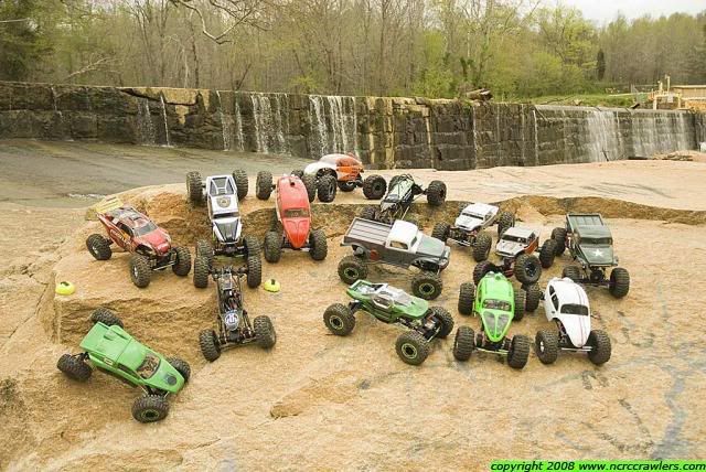

I've managed to place better at each event I go to. I've also managed to put about $700 into my crawler. Now my silly a$$ is thinking about going MOA with HR axles.
Here is a pic from my first crawl. I'm running the RustlerVXL body on the left. We are averaging a little over 20 crawlers per comp. these days.
