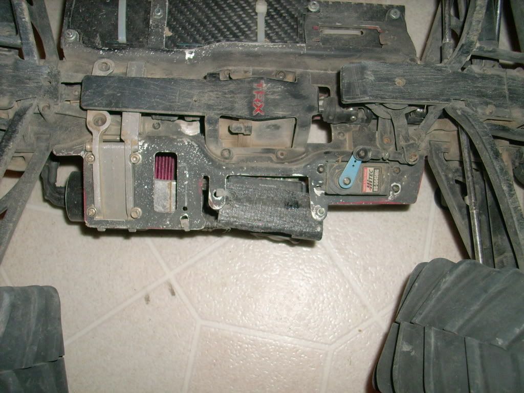

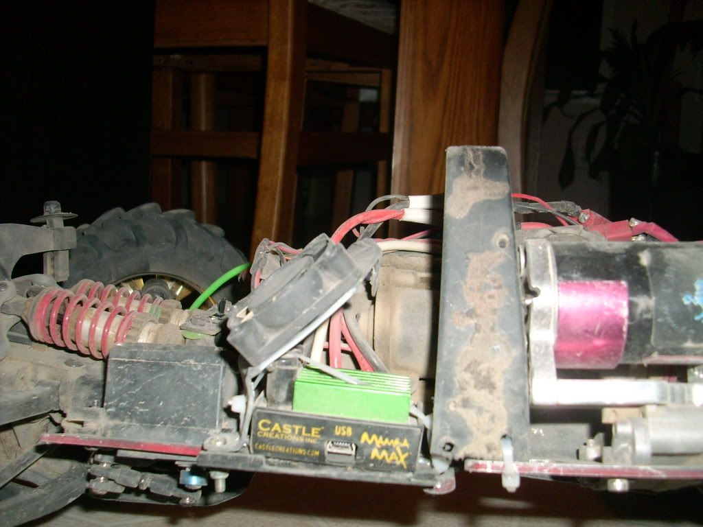

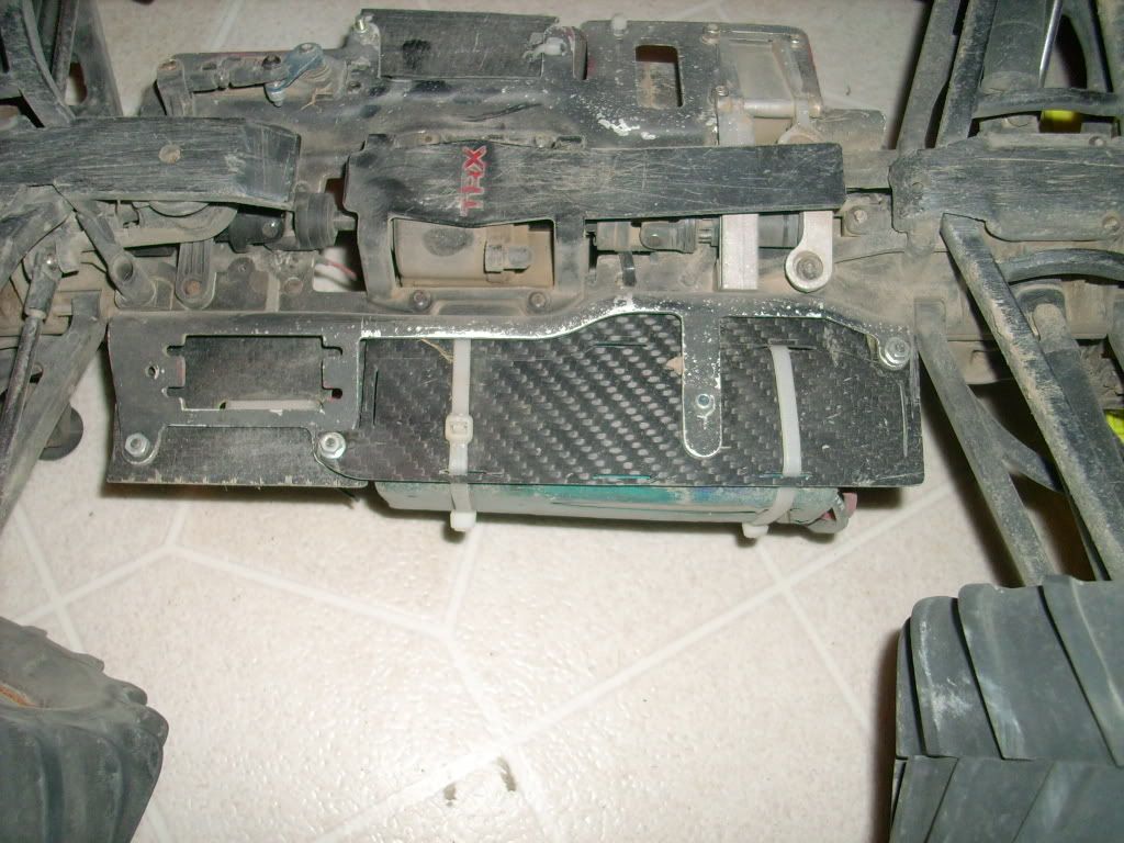

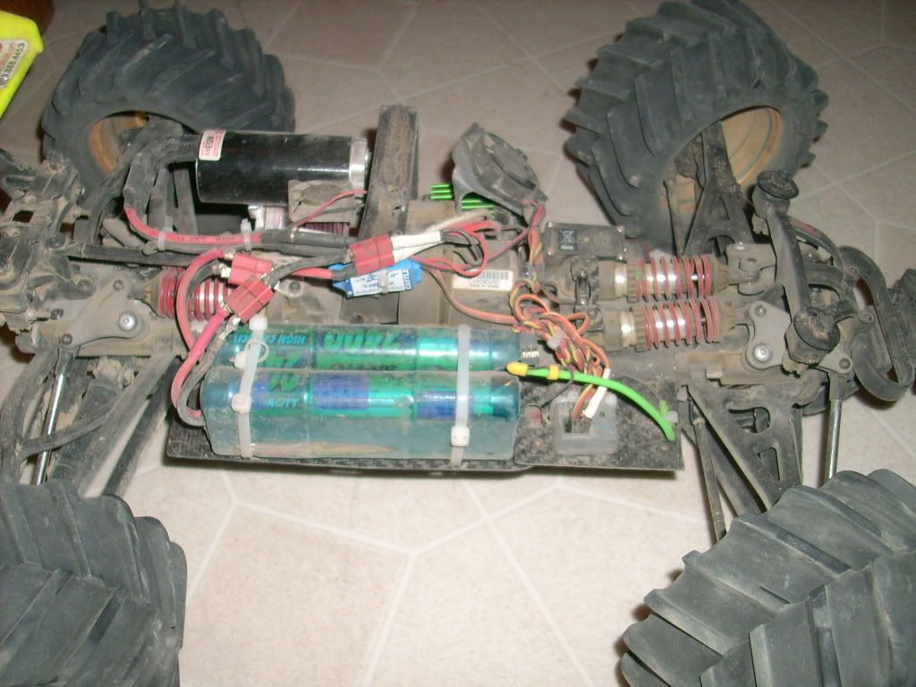

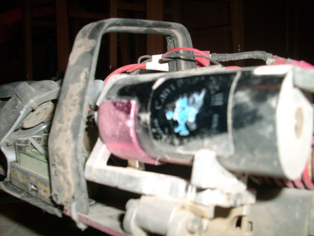

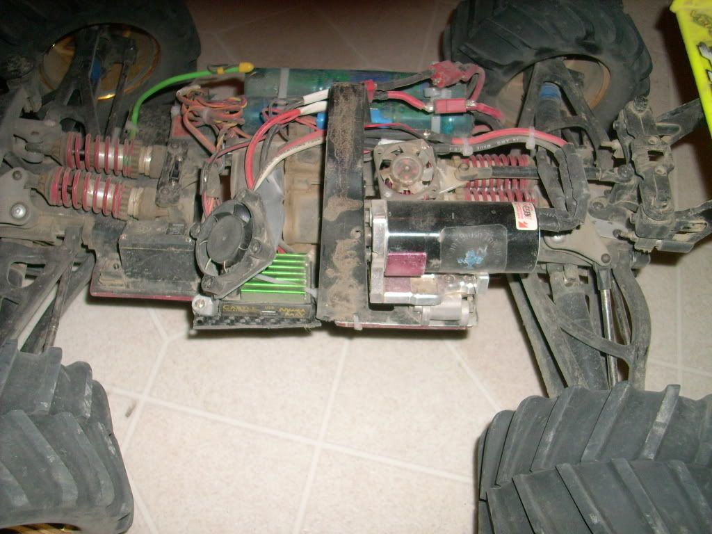

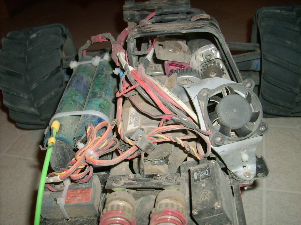

finally finished my revo conversion three days ago. MM 9XL RCM motor mount. CC bec and other odds and ends to get it completed.
i custom made a CF battery tray, esc mount, receiver and on/off switch mount. the tranny is locked into second gear (wide ratio kit) also running a center diff (need thicker oil..only 100K) cant wait to get a 4s lipo thatl make this truck scream!!!
ok enough talking off to the pics!!!!!
the truck has alot of wear and tear its 4 or 5 years old..My first nitro rc. sorry for the dirty pictures i just ran it at a construction site for a new highway a few mins away.
