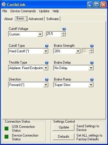

They are what we car guys call drag brakes. Brakes kick in as soon as you start returning throttle to neutral. Just takes some getting used to.

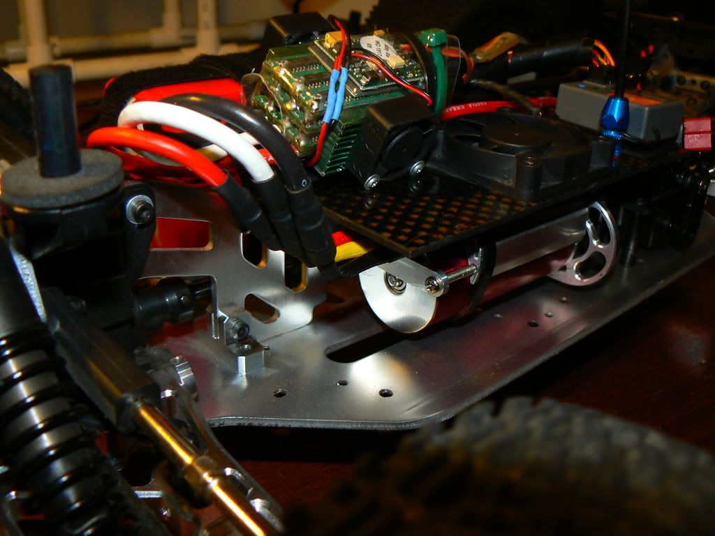

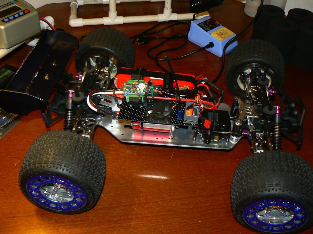

I just finished putting my HV-110 (with PiStix adapter) and 8S lipos in a 1.8 truggy with a 9XL and my settings are as follows:
I started at about 40% and that was some seriously hard braking so I went all the way down to 20% and kept brake ramping at super slow.
Some more photos of my setup:
Don't fear the HV-110.

Nice truck Sunny! So you are saying it just operates as a drag and lowering the throttle down to neutral at varying rates affects your braking? I hope I am wording what I am meaning correctly with this.

Thanks man! You got it. You can also adjust the brake strength and brake ramp via software to your liking.
I found that jumping with the HV-110 is pretty hard with the drag brakes, but I am sure it can be done. I don't care much for that at the moment.

8S with a 9XL!!!! Wow I just ran a 9XL on my revo on 6s A123 (geared for low 40s) and it was getting toasty - close to 150...
What temps are you getting on 8s?
SunnyHouTX
SunnyHouTX's Avatar
Posts: 396
08.12.2008, 12:00 PM
I was just driving around the parking lot for about 10 minutes in 90's ambient temps and it read in the 140's at the end. I have a 6-cell NiMH RX pack that makes the fans move some serious air. I imagine, things will be manageable, especially when it gets cooler over here.
Unlike BrianG (I think ) I like fans. A lot.
