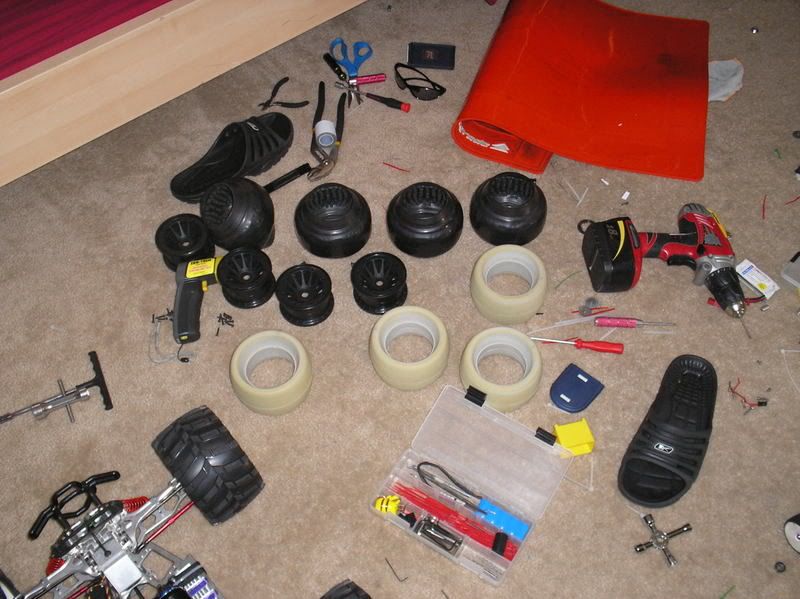

Last night i got my maxx setup and drove it for the fist time in ages with my MMM and i too am running maximizers on badlands because i liked the look and they are all terran. after driving a few questions came to my head
1.) what do i do to stop the balloning
2.) why are they so unballenced
3.) why did i rip the tires right out of the beadlock
so to prove that i am not joking heres a pic of my tires laying in the floor ready for taping to be done.
[IMG]Photobucket[/IMG]
thanks for the thread as it will be very useful to me
