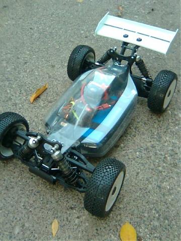

So apparently I wasn't the first to have one...but I sure was close
Just a few bad pictures I took with my phone. I will take some with the Canon later in the week.
All I can say is....
This thing is awesome.

looks good. i want one so bad lol. but saddly it would be nitro and my 5r would be brushless . that way i can race the 6 at the local track and not have people getting mad at me lol.

Nice buggy!
How's the Mamba Monster doing?
Any problems?
