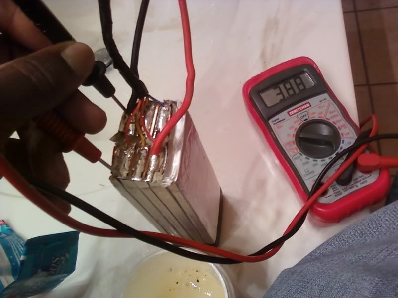

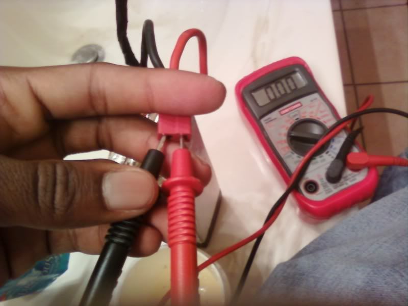

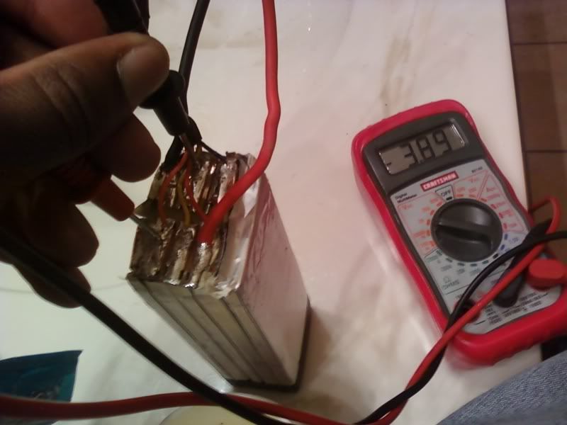

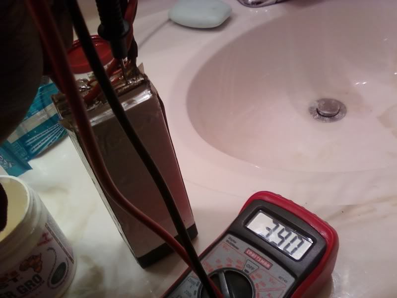

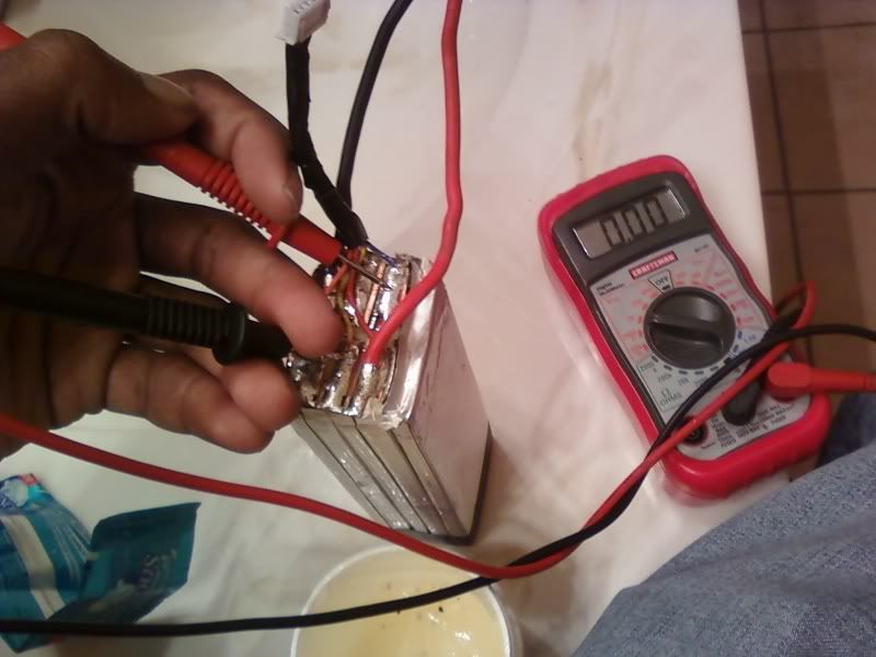

ok, i would need one cell removed...
Its an odd problem. all the cells are reading 3.87v except for one which reads 0.0v and i get no votage through the deans plug. like there is a physical break somewhere as there is no puffing or anything visible..

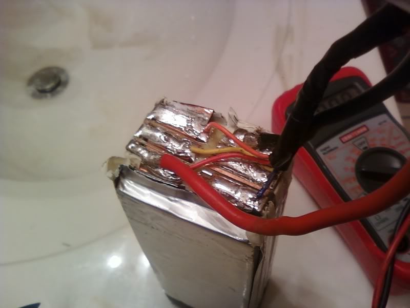

hope this helps a bit
10.22.2008, 07:44 PM
That pack looks like the cells are soldered together. Showul be easy enough to seperate the cells and check them individually. I would remove the bad cell asap. Leaving a bad cell in the pack can kill the others...

AHA! I found it, the number four cell has its tab broken off..
10.22.2008, 09:07 PM
You will most likely not have much luck fixing that, they usually break off too close to the foil to get to. Maybe a pic would help...
