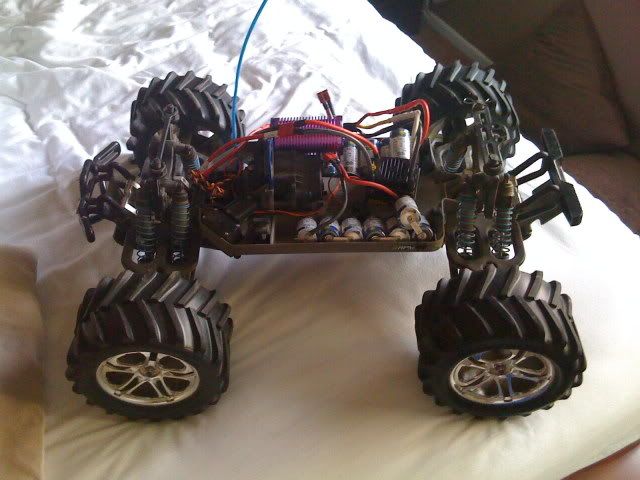

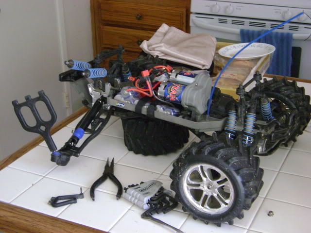

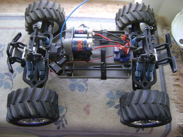

here is the picture of when i got the truck
fixing the shaft i broke after two packs
i havnt taken any new ones. ill take some tomorrow because its too cold to go get my maxx from teh workshop right now! and im tired but as soon as i get up ill get them going i need to tidy the wiring up though it kinda looks busy in there lol.

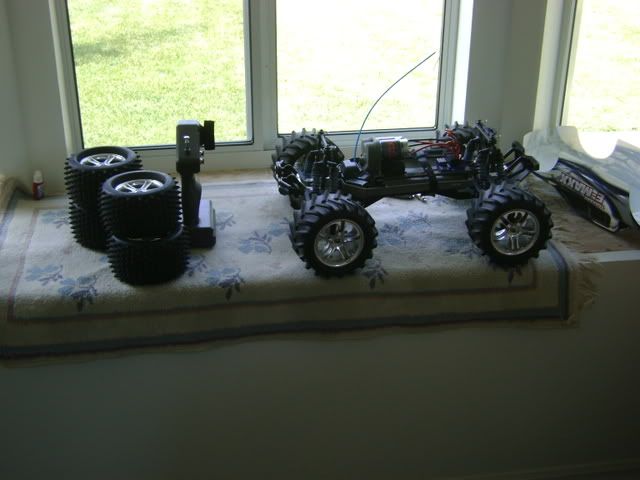

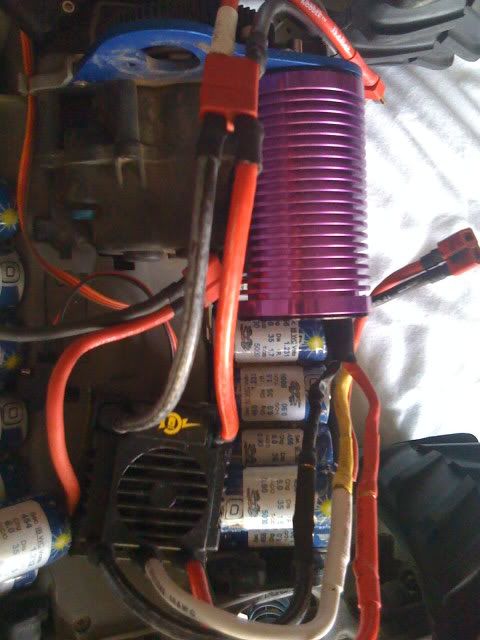

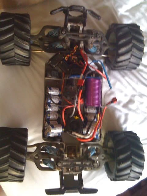

12.02.2008, 01:59 PM
alright i just took these about 10 minutes ago. sorry about the quality the iphone camera kinda sucks. i cant find my good camera.

12.02.2008, 03:59 PM
Not bad- any specific reason you are using the lower motor mounting location rather than the central one? I doubt your stuff will turn up today though- it may have left towers warehouse, but your local postoffice may kidnap it at some point...

12.02.2008, 04:07 PM
to answer your question neil it rubs in the upper mounting hole. the motor is too fat but im going to mess with it a bit to see if i can get it to go in there.
