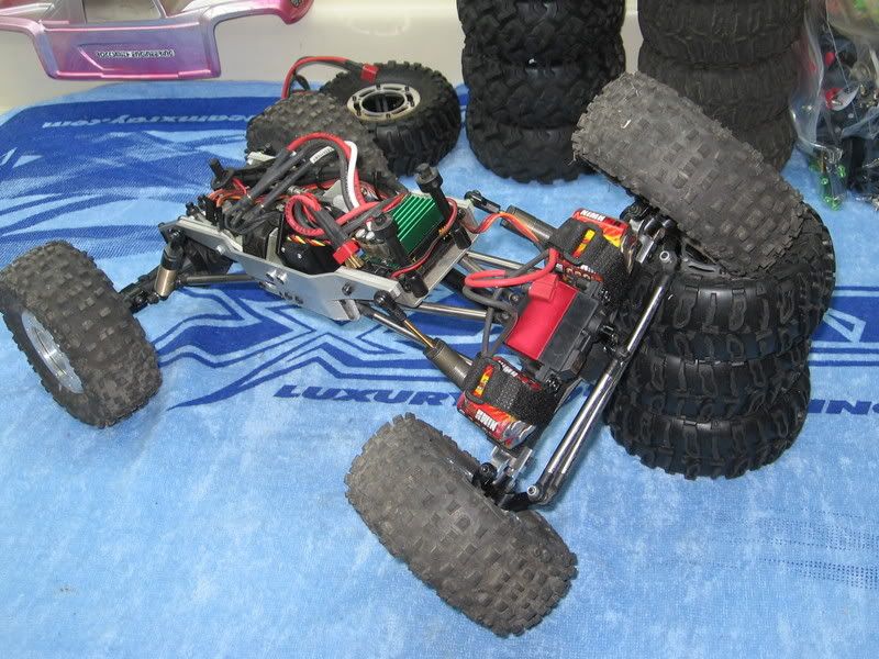

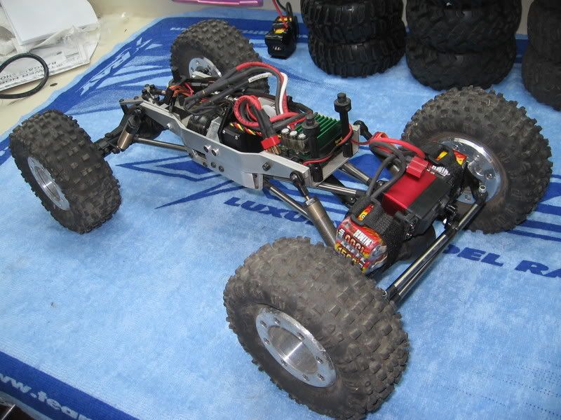

Anyway on too the pics..
Here is everything it came with..

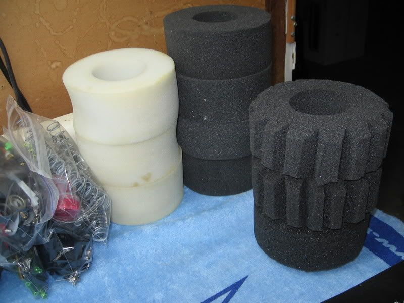

Can someone please explain the foam (?) and especially the ones cut like tractor tires (?) what do I do with those (?) I'm told that I have memory foam in them now, so do I even need to keep the foam one I have (?)..
Here is the beast!.. LOL..

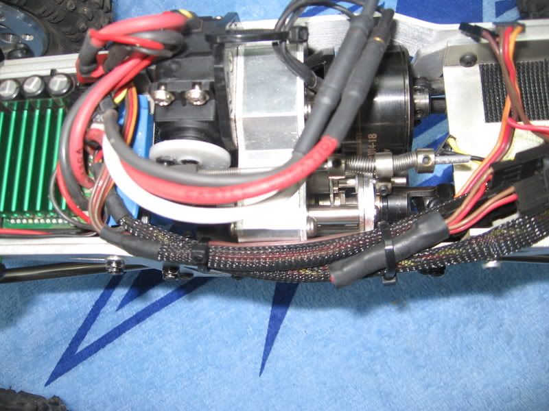

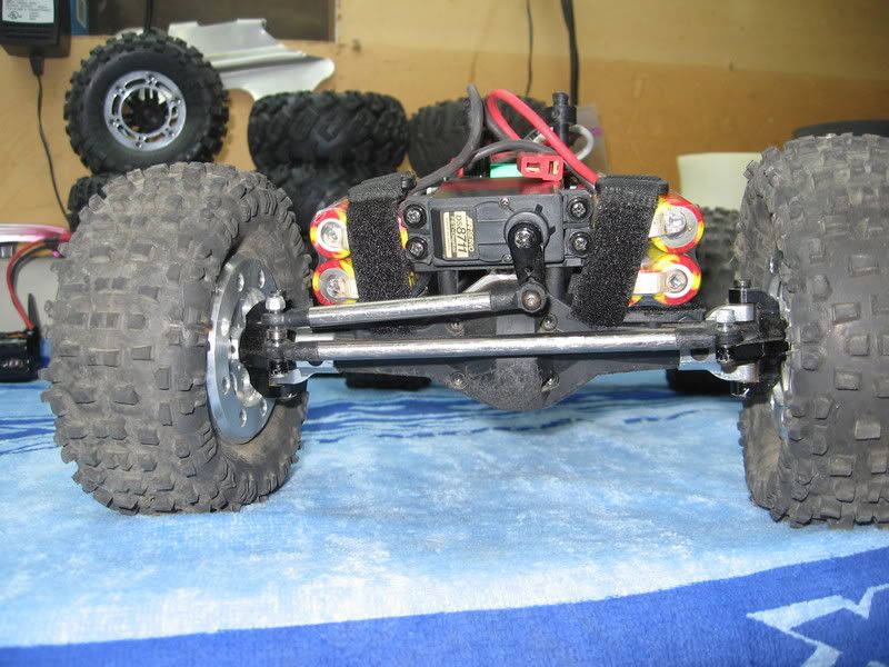

Here is close-up of the DIG and wiring:
Nothing!.. Hahahahaaa..

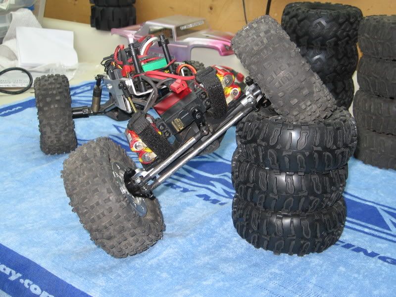

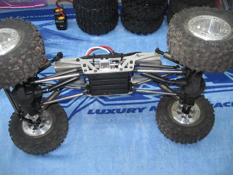

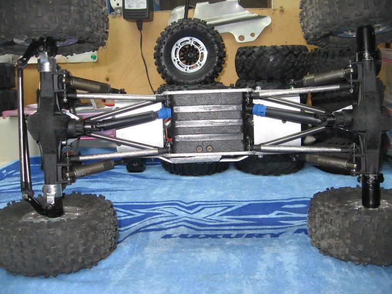

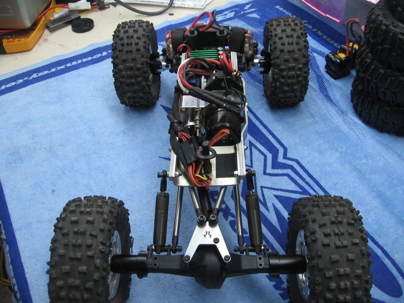

The underneath:

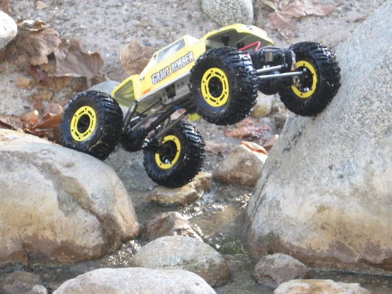

Is this lift average (?) I have no idea what so ever. I'm thinking it should be almost vertical right (?)

The cut foam compresses more easily to provide better traction - Thats about all i know about crawling...
Here is a guide:
http://www.rcuniverse.com/forum/m_5272041/tm.htm

You will have incredibly long runtimes because it's such a low-current set-up.
The articulation is perfect. We used to think that more (90 degrees) was better, but it is actually a detriment more often than a help. Too much can allow a tire to drop into a deep hole that it can't get out of.

Can someone please explain to me what the DIG set up does and how it works, why its helpful, etc please? Thanks in advance.
Dig is used essentially to allow the crawler to pivot around its rear tires. Dig can have different positions - the first is 4wd, the 2nd is locked rear driveshafts, and sometimes there might be FWD. When locking the rear driveshafts there is front wheel drive and the steering from the front. This results in a much tighter turning radius which can be helpful for getting around obstacles. The FWD/open rear driveshafts also yields a tighter turning radius, but isn't as useful for avoiding obstacles.

Thanks Travis. That really helped. As for the servo, I am assuming that it is what switches the transmission from 4wd to fwd/locked axles, etc? How do you usually set it up on your radio system? Is a 3 channel radio enough? Thanks again.
Yep, the servo actuates the dig. 3 channels is a necessity for dig, for sure. Dig, however, isn't necessary IMO. It does help, but if you're not competing there's no real need for it (IMO).
Here is a guide:
Got it! that makes a lot of sense..
Thanks for the link Chris..

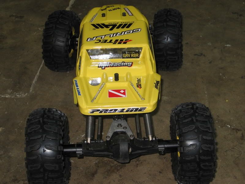

So I had the opportunity to paint my first body this weekend, nothing to fancy but all and all it think it turned out ok.
Then I had the opportunity to spend some time at the park with it:
