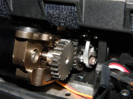

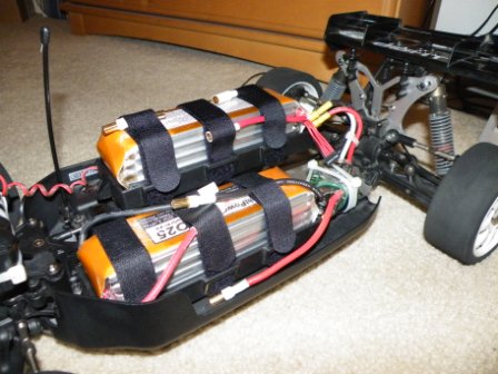

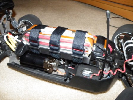

Hey guys,
Thought I would post some pics of my new project. It is a LOSI 8T with 8B arms to help reduce drag induced by the open wheel design. It has the 8B diffs as well for more top end. I ran 83mph with it on a Mega 22/30/1E on MMM on 5S with 18/38 gearing. New setup is HV85 on 10S with a Neu 1515 2.5D and a little more gearing......all done on the LOSI brushless conversion kit!!

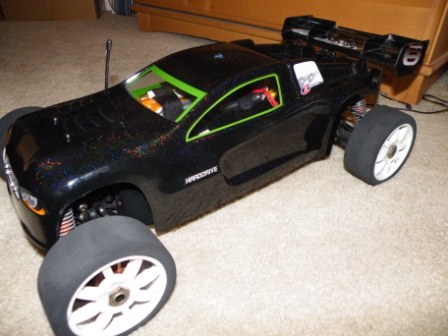

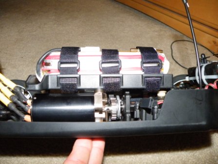

Here are a few more pics...
