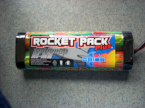

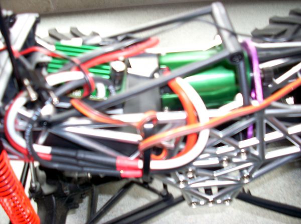

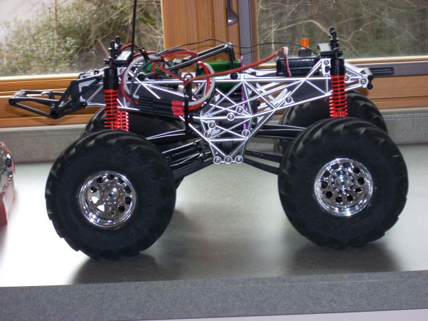

Hi everyone, I finished my second BL project about a month ago, a BL Wheely King. I get speeds of 35-40 mph, 40 minute runtimes and it runs cool. Its a Blast!
Parts Used:
MM 6900kv Combo
Hpi Heavy Duty Differential gear
Team Orien 3900mah 6-cell rocket pack
RC4WD Stainless steel turnbuckels
Hpi 23t pinion
Hpi 93t spur

40mins with a 3900mah rocket pack? Im impressed.
Only thing I would suggest is to slam the suspension some how (longer links or shorter shocks, or both), and that will make it handle the high speed alot more stabley.
