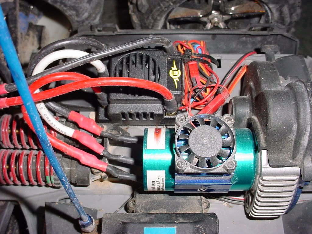

I installed this Medusa 36-60-1500kv in my E Revo. Realizing the lower Kv multipole motors make more torque than their high revving 2 pole counterparts, I decided to go with the same gearing my AXI 2826/8 motor had been pushing around. The gearing is Mod 1, a 22 tooth motor pinion and a 40 tooth Nitro Revo spur.
Now this is some pretty high gearing, so I figured it best to keep an eye on temps.
Maiden voyage for my Monster Mamba using this setup. I LOVE this ESC. No problems thus far. She's running like a champ. I love it.
First run was on 4S 20C 5000mah Lipo. Performs very well. Temps were well in hand even without a heat sink.
On 6S, it's impressive. This little motor REALLY puts out some good power considering the gearing. According to Brian's Speed Calculator, on 6S, this is geared for 60mph.
6S operation is what made me install the fan/heat sink on the motor. Without it, temps would get out of hand pretty quick. I ran it for about 10 minutes without and decided I better stop.
6S operation is good with the fan/heat sink installed. The ESC is more stressed as the fan cycles on and off, and seems to be stimulated by WOT runs. LOL I think my pair of 3S Lipo's have just about had it. It was getting on the LVC about halfway through the run. They are about a year old now though and have seen alot of abuse. I know I overamped them several times on other setups. What's a good set of 3S Lipo's to go with for the E Revo? I'm looking.
Sorry for the gob of wires, but there is a CC BEC in there programmed to 7 volts running the fan only. Servos and Radio are both being powered by the ESC.
I'll do some more runs and testing tomorrow. Perhaps 5S is the sweet spot for this setup.
Here's a pic.
