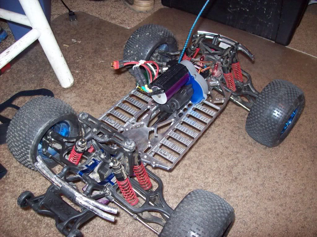

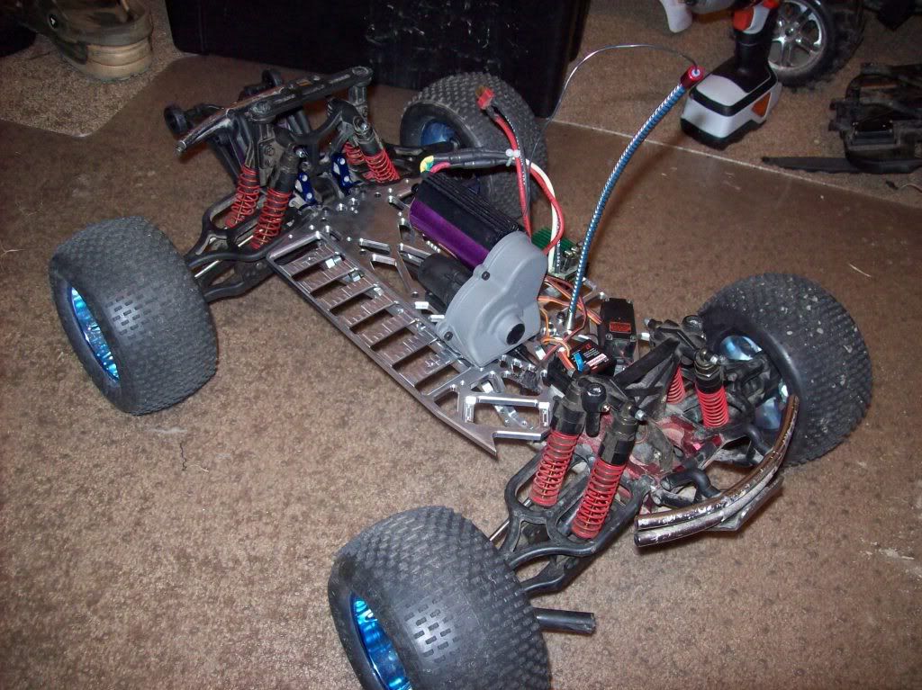

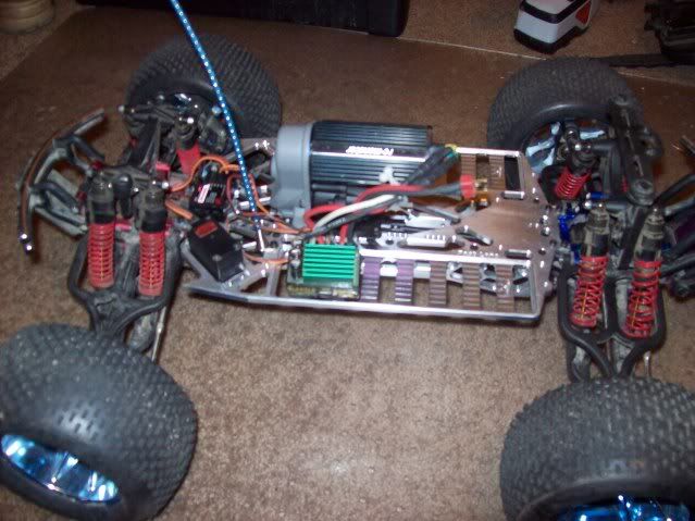

heres my emaxx so far
03.12.2009, 04:26 PM
Tip: hit return a couple times between the img links, so that they appear one beneath the other- not side by side and take up 3 screens
Looks good so far.
