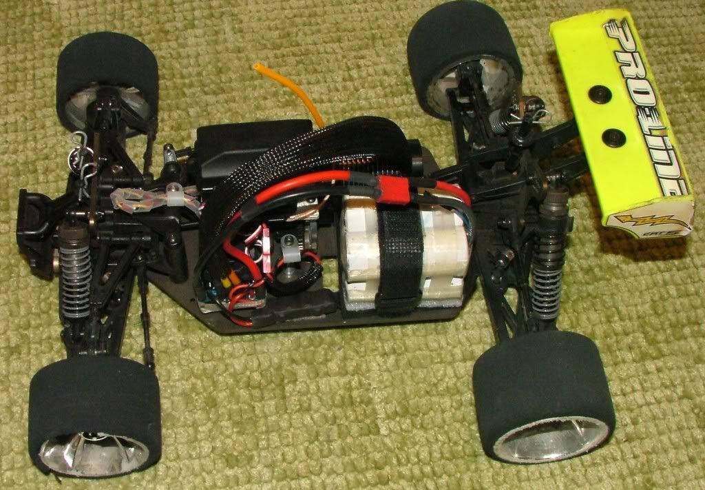

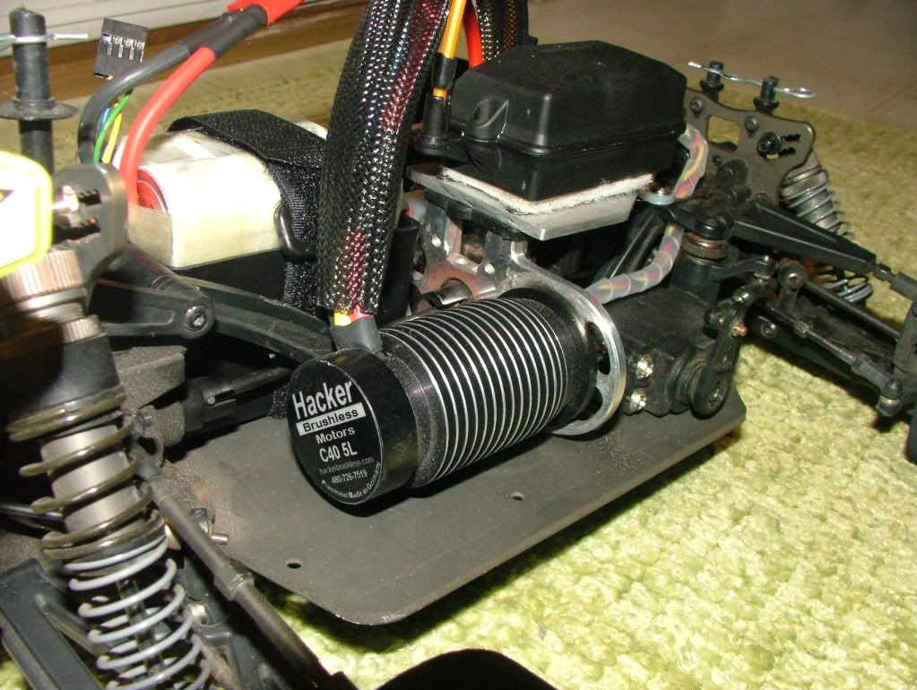

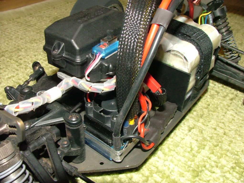

I've been running the LT-200A sensored ESC in my CRT.5. I ran around 6-8 packs with an LRP-X11 3.5T motor. Was pretty quick and smooth. Since I have some more movement in my right arm now, I soldered up the new Hacker motor(6000KV) that I recently got. I like it alot better and it's stays cold. The LRP got to 149F after the pack dumped and the ESC at 119F or so. I can probably gear higher for dragracing, but it's pretty quick to bash with right now. I busted up one of my foam tires in the vid.

That thing has zero grip there lol
Oh btw... where did you get that braided sleeving? The only online shops who got it got a minimum order of 1000+ meters

I bought 4 A123 cells from Holmes Hobbies and homeboy ships quick. I was going to get me some G3 Lipos, but the A123's were just a good deal. Anyways, I built the pack really quick and ran 3 packs through the crt.5.
Brian calculator spits out 70mph. It looks more like 65mph. The motor just goes nuts on 11.7 volts and the poor crt doesn't know what hits him. I'll do a vid again once my new foams come in. Motor is around 130F.
Differential Ratio: 3.25
Transmission Ratio: 1
Other Ratio: 1
Spur Tooth Count: 46
Pinion Tooth Count: 17
Total Voltage: 11.73
Motor KV: 6025
Tire Diameter (inches): 3
Tire Ballooning (inches): 0
Motor Current Draw: 45
Motor coil Ω: 0.0044
Spur/Pinion Ratio: 2.71 : 1
Total Ratio: 8.79412 : 1
Tire Circumference (inches): 9.42 inches (239.39 mm)
Total Motor Speed: 69480.3 RPM
Vehicle Speed: 70.51 mph (113.27 km/h)
Effective KV Value: 5923.3
KT constant: 0.22 oz-in/A
Motor Torque: 0.05 ft-lbs
Final Torque: 0.46 ft-lbs
Final Power: 527.85 watts (0.7 HP)
