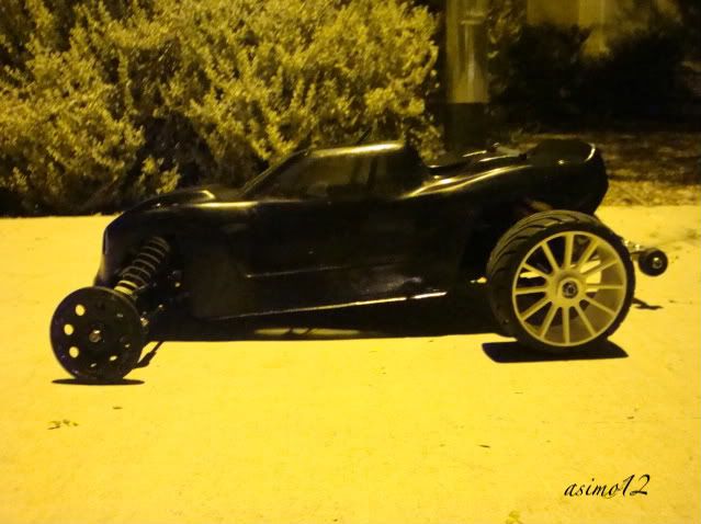

Originally Posted by DwightSchrute View Post
thanks....but those losi rally tires in my avatar pic are good for atleast 103mph....and i'm knocking on 95 right now. i will post video for sure if i can get a 1521 or 27.
Yea those losi are pretty awesome.I pick up a set to tried out a set about two month ago and not going back to the belted ofna after they blew up.I hope that you all hit that century mark soon.
WOW that is a crazy ride. is that a rustler? those shock springs look familiar.
