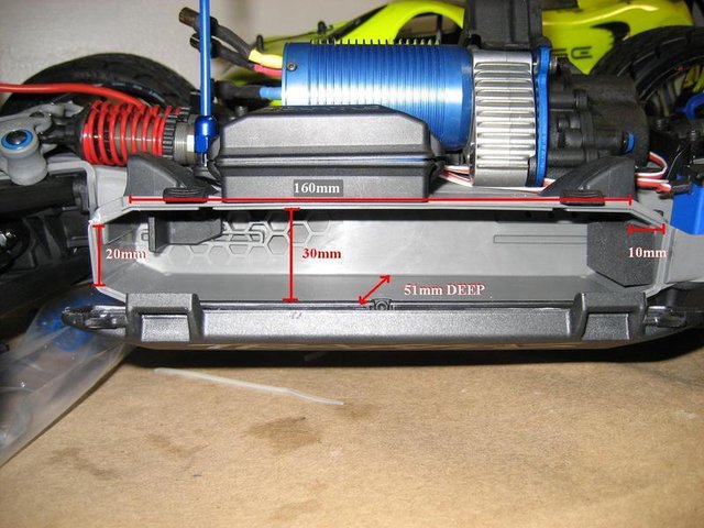

Does anyone know what size the Battery Compartments are on the E-Revo? I have one coming this week and want to know what im going to need for it, battery wise? Im def going to run 2x 2s 5000mAh 30C packs. HobbyCity has some deals on those right now. 30-40 bucks depending on what u get and they just released the 30c packs last week for 4,5,6 cell lipos
Couple of em are hardpacks which doesnt really matter to me.
So dimensions on the E-Revo Brushless Edition Battery tray is?????

The Flightmax 2s 5000mah 30C are what I bought and they fit snugly. The wire has to be facing inward for them to fit.
