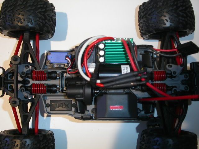

I just finished mine with an 1110/1y with MM esc on 3s with stock gearing and its 100+ outside here in austin texas ....after making speed runs up and down street 5 or 6 times and motor was 108 and esc was 127
...yeaaa finally remembered my password on here ..lol
08.06.2009, 06:49 PM
That is one tight compartment
austinmaxx
08.06.2009, 07:02 PM
I am making a little esc mount, that will move the esc over the rear shocks like i have on my 3.3 converted e-revo, it will give the esc more protection and make it cleaner looking....the neu is actually shorter then the stock motor and is slightly larger diameter than stock and the esc hangs over side 1/8 inch or so (which bugs me)
08.06.2009, 09:23 PM
Bah, details details. Seeing an MM and Neu in a 1/16 truck is all kinds of win
