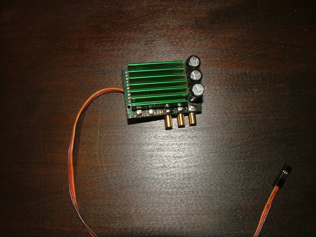

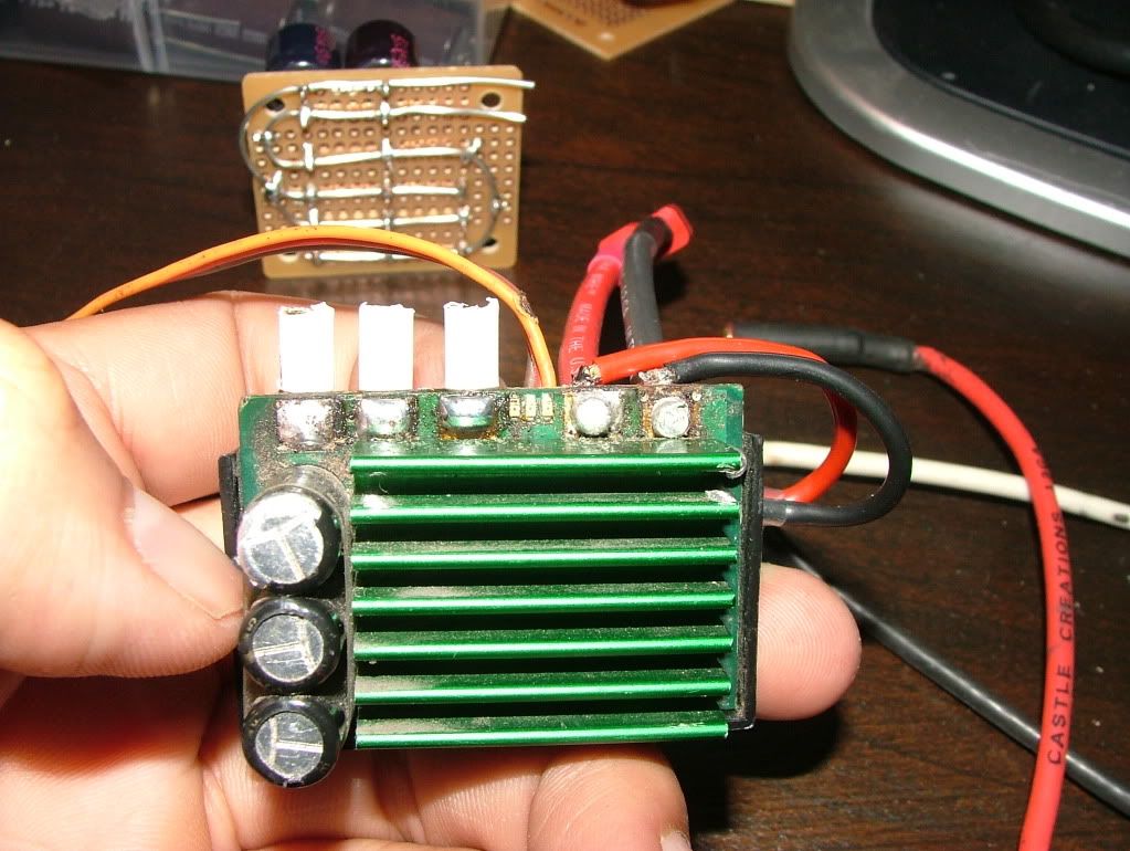

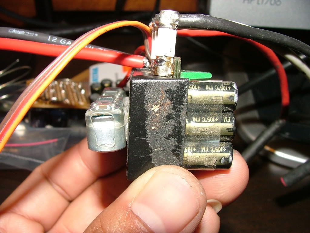

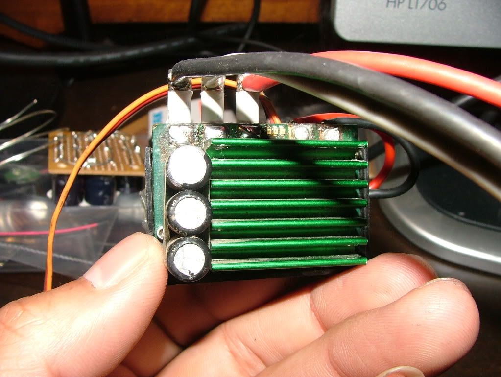

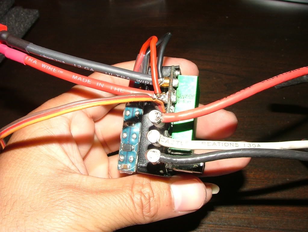

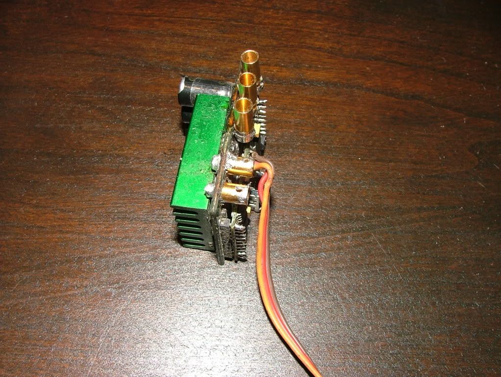

I've decided I got tired of the same 'ol look of the Mamba Max and did something about it. Took out the wires and soldered plugs instead. Power wires were upgraded from 13AWG to 12AWG. Motor wires were left stock and got 3.5mm plugs on the ESC side. This time I can mess around with different motor wire lengths in all my cars without being stuck with wires that were cut too short. I used Lutach's 25V capacitor bank for that extra touch of gangster.

Is that blue PCB in the 4th pic a custom capacitor bank you made?

No, that's Luciano's cap bank that I got from the ESC's that he sold.
