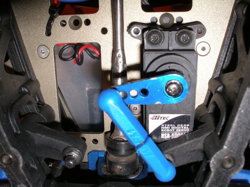

I have one of these in each of my 2 LST2's with no servo saver;
http://www.hitecrcd.com/servos/show?name=HSR-5990TG
I broke several of the Dynamite aluminum servo hrons but have switched to the hard anodized Losi horns and there much stronger.

bondonutz
can you post some pics of what your single servo setup looks like for the rest of us to view.

Your wish is my command my friend,
If your wondering why the center shaft looks that it's because I lenthened them 1/8" via mig welder to keep them from slipping out of the tranny outdrive.

08.29.2009, 05:21 PM
thanks for the pic.
How long have you been running this setup?
Do you have full steering throw with this setup?
Do you still have the RPM and pivot ball stud part numbers?
I'm thinking of trying your setup on my lst2's.
Thanks tim

08.29.2009, 05:36 PM
Has Full throw,no issues.
Ben running this set up 4+ yrs, Had a JR 9000T till I swapped out with the RoboServo.
http://www.rpmrcproducts.com/product...c/steering.htm
