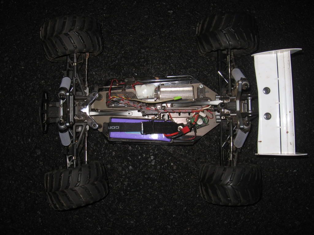

09.04.2009, 08:26 PM
So after millions of changes and a couple of test runs I'm very happy with my truck. A couple of changes are bald tires :), mmm 2200 combo, 4s 5k maxass 20c batteries(looking to upgrade to 5s for under $100) and some heavier springs. It's still not as firm as I'd like it suspension wise but I'll have to deal with it for now. As for the center I threw 100k diff oil in it to stop the front tires from turning into pizza cutters.
I've run into a recent dilemma though it seems like my motor mount from rc-monster is bent. I've been trying to figure out how for the longest. And since it's bent it's eating up my pinion gear (rcm). So without further ad here are some pictures and a short vid of my hyper st.
09.04.2009, 08:29 PM
I would suggest that the complete lack of a centre diff top plate is probably the cause of the issue with the motor plate bending...
Best replace motor mount and install centre diff plate before you kill the motor...
