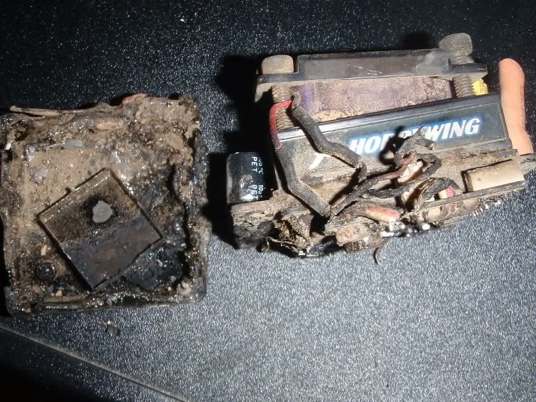

I just burnt my 2nd EZRUN ESC. See the picture, I almost lost my Truggy, I was lucky to end the flames on time.
Looking for a new ESC. which one is better for 4S power? mamba monster or TEKIN RX 8?
I'm going to buy only the ESC and not the entire combo.

Get a Tekin RX8 or MMM, you are much better off spending a little extra cash for a higher quality product... yeah sure all products are not bulletproof. But, from what I have seen the EZRUN, I have seen almost as much failures from them than Tekin or Castle, and alot less people use EZRUN escs, so what does that tell you?
I have a Quark that is over 2 years old now and is still running fabulously, albeit with some mods, but still.
10.09.2009, 02:15 PM
I assume that's the 80A version that burnt? If so, I would think about stepping up to the 150A version, especially in a truggy. To push a truggy well, 4s requires quite a bit of current. 80A might be enough when running 6s on a matching motor kv, but the 80A is only rated for 4s. Remember, despite the physical size, the 80A is basically a MM capability-wise.
If that was the 150A version, I would look at adding extra caps/TVS modules in case it was some braking spike that overvolted the FETs or to help reduce ripple currents.

Are you changing the punch or timing settings on the hw? That is pretty much proven to send it to a fiery death. That 150 should have been fine.

The punch was at 4.
