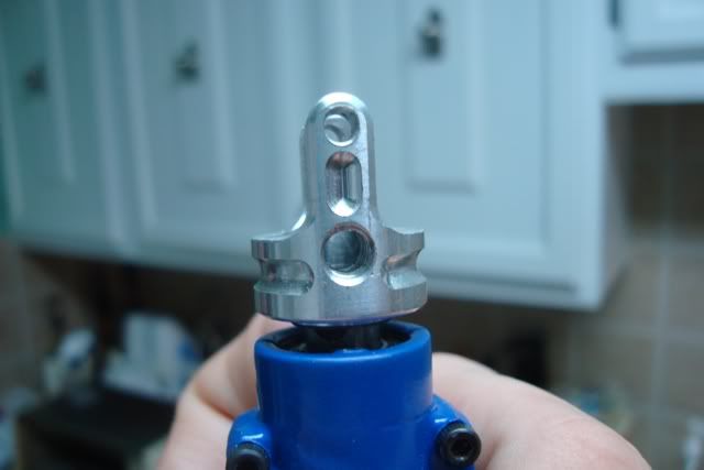

Well I am in the middle of an LST upgrade for my front and rear diffs and I'm stuck....I have the diffs mounted in the bulkheads perfectly (thanks MC!) But I have run into a problem. I ordered the 8mm Aluminum couplers from Mike and I got them yesterday and they don't fit...The 8mm part is too shallow to fit the whole shaft in...What do I do now? I tried drilling the coupler out longer so it would fit and it just doesn't fit right...Any suggestions??

Pics would help to show exactly what the problem is here.

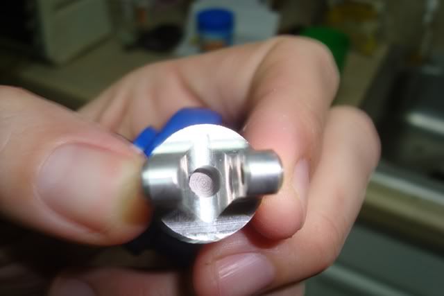

Deahttub
02.20.2010, 08:59 AM
Here are the pics...
This is as far down as I can get the coupler
Here is a top view...
Am I stupid? This will not work right?

Yup, The grub screw is way to high AND needs deepening for the output shaft.
02.20.2010, 12:54 PM
Ok, moving the grub screw will not help.
The lst pinion needs to have the couple tight against the inner bearing race of the outside bearing. If not the pinion will "walk" into the diff case and cause mesh issues.
I have the original rcm steel couplers like you pictured, I will get a shot of them at work today and you will see what needs to be done. The center hole needs to be drilled to 8mm all the way thru. that way you can slide the couple down and have it touch the inner race and the pinion will stay centered between the bearings.

I drilled one all the way through and the grub screw still doesnt match...I don't know what I did wrong, but the hole isn't perfectly straight, so I guess i ruined one...the grub was still high, and lowering (the grub screw) it could help but it wont be a perfect fit i can tell you that....I emailed Mike and I'm still waiting for a response....

As myself, I found I had to grind down the little lip on the output diff shaft. Sorry I forgot to mention this.

In order to make the aluminum coupler work on the LST diff, the coupler needs to be reamed to 8mm all the way through and a new set screw threaded hole needs to be added(to the opposite side) to properly engage the pinion shaft. You can send them back to me for the modification if you like. :)
