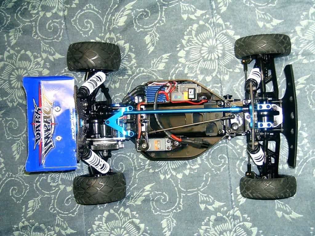

HI!... Well I picked the DARK IMPACT up on Friday and started building it right away.
Well I made a stupid mistake and put all the stickers on and afterwards realized the body had a clear tear off coating on it! LOL! So needless to say they are all scrap now. So after painting the body today I just threw on some stickers I had laying around.

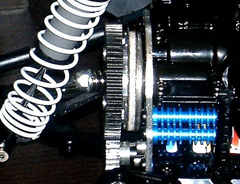

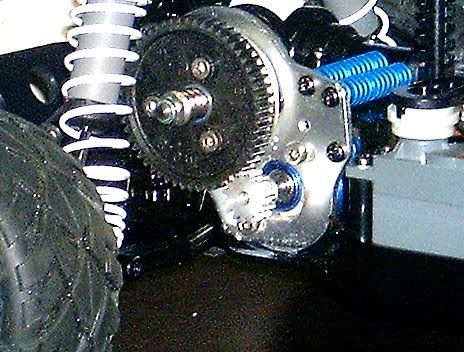

HI!... I didn't car for the spur/pinion gear set-up on this thing. Teeth are way to fine. With me running a brushless 6000KV motor I figured they wouldn't last too long. So I built a conversion kit and converted it to a M-0.8 gear set-up. Currently running a 54spur/15pinion.
Here's my ESC/RECEIVER set-up :

HI!... Well I picked up my slipper clutch and started modding it already! LOL! I still want to run my M0.8 gearing set-up. So I took the gear shaft from the slipper clutch kit and drilled a small hole in it to accept a dowel pin. Then I simply modded a TRAXXAS slipper clutch and mounted it. Turned out pretty good. Sorry for the crappy pics, old digital camera.

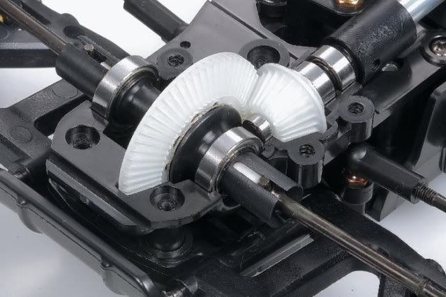

HI!... Well I've been talking with a gear company across the way to get some bevel gears made up out of steel (hardened possibly). They want me to send them some of the gears I want made out of steel so they can look at them and get me a quote. Would there be a interest here in buying some of these gears if it's feesable? Probably the more I get made the cheaper they would be.
These are the two bevel gears I'll be sending to them :
Is there any other gears that are prone to breaking that I should have them look at as well? Let me know and post up a pic of what you think would be another candidate.

The aluminium idler(or whatever I would call it) in the rear gearbox was the first to go in my df-03. IMO the bevel gears do just fine as is.
TG
HI!... I must have a newer version then. I have no aluminum idler in mine. All gears are plastic except the main spur gear shaft gear which is steel on mine. There's guys on other RC sites that are destroying the bevel gears front and back and melting the large diff gear in the rear. I've been told to stay away from the front one way due to it destroys the front bevel gears.

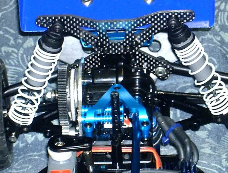

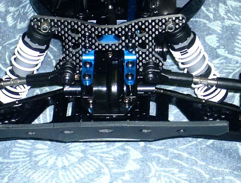

HI!... Well some more parts came in today. I got the 3RACING front/rear composite shock towers, one piece inputs, driveshaft, front "A" arm support and rear gearbox support. I still have to get the higher voltage electric fan for my ESC and the CVD's.

Looks great! You know in the first picture the back tires need switching around to make the tread direction right unless you are doing that on purpose and in the las picture all the tires are on wrong. Regardless of the other pics in which I didn't look at the tires. Nice job otherwise! I was thinking about doing one of these but I didn't know it had a ball diff.
