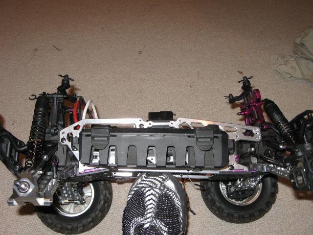

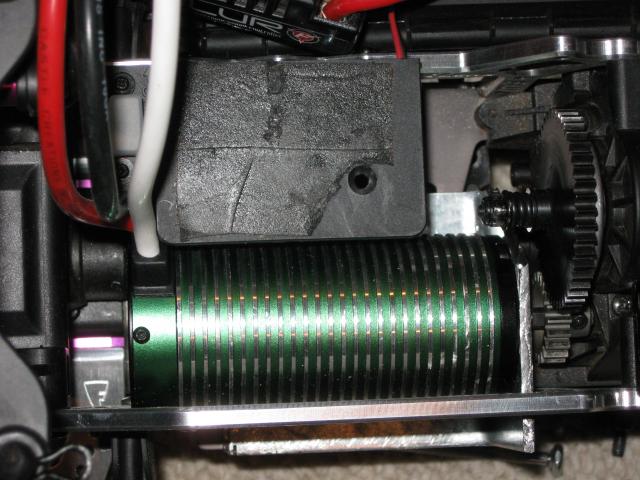

I have recently put the cc sale motor to good use in my flux. With a little ingenuity and alot of dremeling i got a clean custom fit. I made my own motor mount which limits gearing to 20t pinion 44t spur or if it i go smaller spur i can fit a bigger pinion vise versa. Also what is the best lipo setup for this motor and mmm esc. I currently run 5s. Any suggestions to run the most optimal setup would be appreciated

Here are some pics of my build

Noob ? how do you upload more than 4 pics at a time?

I appreciate everyones post and input. Brian,I did not specify any specific goal other than to post what worked for everyone so i could get an idea of where to start. It is really unecessary to take anything personally on this forum as it is impossible to tell the mood of "text" in a conversation. As far as the servo mount, im not sure if it is the norm but it replaces the big and bulky box really made for the nitro savage and it is alot easier to work on with it mounted this way. I ran my new setup twice and if feels alright but i think 20t/44t is a little much for this motor as torque was lacking a little on 5s(believe it or not)?

Thats the way I mounted my servo in my savage. Is that very common? IDK
