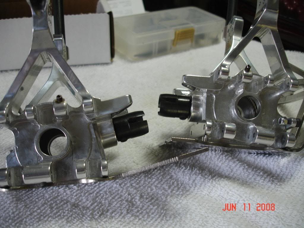

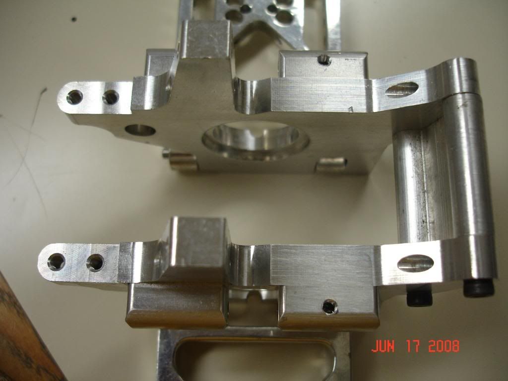

The UE diffs are just regular Hyper 7/8/8.5 with UE's diff output shafts while the Hot Bodies are hardened diffs. I don't have any experience with FLM's hybrid bulks but I do have UE's VBS bulks GA bulks with UE's 8 and 6 spyder gears respectively. Setup is easier on the VBS compared to the GA bulks.
If I were you, I'd buy the UE diff outputs from UE and the Ofna or Hot bodies diff from ebay and the GA or FLM bulks. This will cost you less than $200.
UE's VBS:
GA bulks with captured hinge pins:
Ofna/UE 8 spyder diff:

okay thanks for the help George, again! Pics were nice!
Do the GA bulks have the diff cases machined in like the hybrids do? By looking at the pic you provided they don't. So when you say to go with the ofna or hot bodies diffs, UE output shafts, and the GA or FLM hybrids, did you mean just the FLM hybrids? Sorry if i'm confusing =)

The GA bulks don't have the diff cases machined into them. You have to use alum diff cases like on the 3rd picture above. You can buy those from UE also for $70 apiece.
So for a GA/FLM setup, you'll need the following:
GA/FLM bulks
ALum diff cases
Diff and pinions from either Ofna or Hot bodies
UE output shafts
For a hybrid setup, you'll need the following:
FLM hybrid bulks
UE output diffs
The ebay link you posted will work but the diff ratio is 43/11. The ofna hyper 7/8/8.5 have a ratio of 43/13. You can compensate your ratio by using an appropriate spur/pinion combo.
