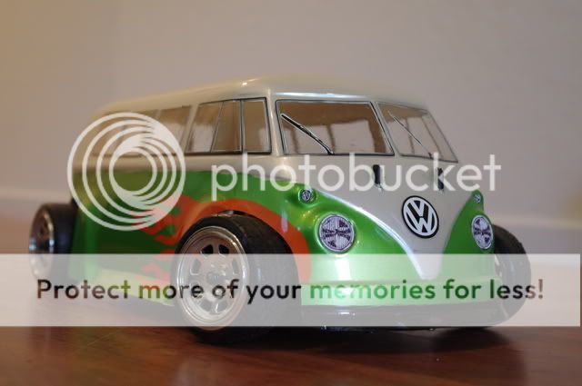

Just go with really heavy center diff oil. Than practice practice practice. I have a warehouse in the back of my office and when I know it is going to be a slow day I bring this guy to work and put out some obstacles to drift around. Fun when your in limited spaces. Thing about drifting is you steer it into the direction you want, gun it, counter steer to get it in line, than throttle in and out through the turn while counter steering and straightening the wheels. Looks like you pretty much have the idea of it. Oh and one way bearings help a bit. Helps whip out the butt end.

Thanks for the tips everyone. Where do the one way bearings go, Reno? I don't think I need it but just curious. BTW what chassis is under the VW?

Under the bus is an Exceed RC Driftstar, brushless and modified of coarse.

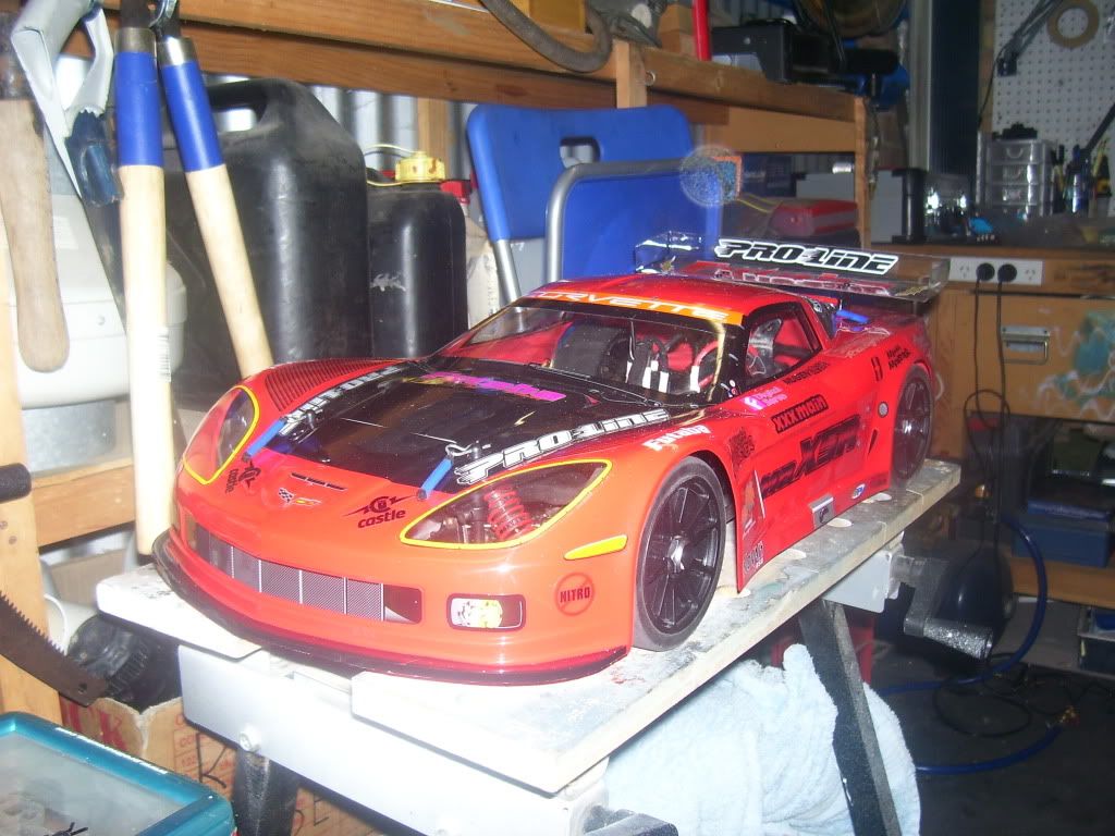

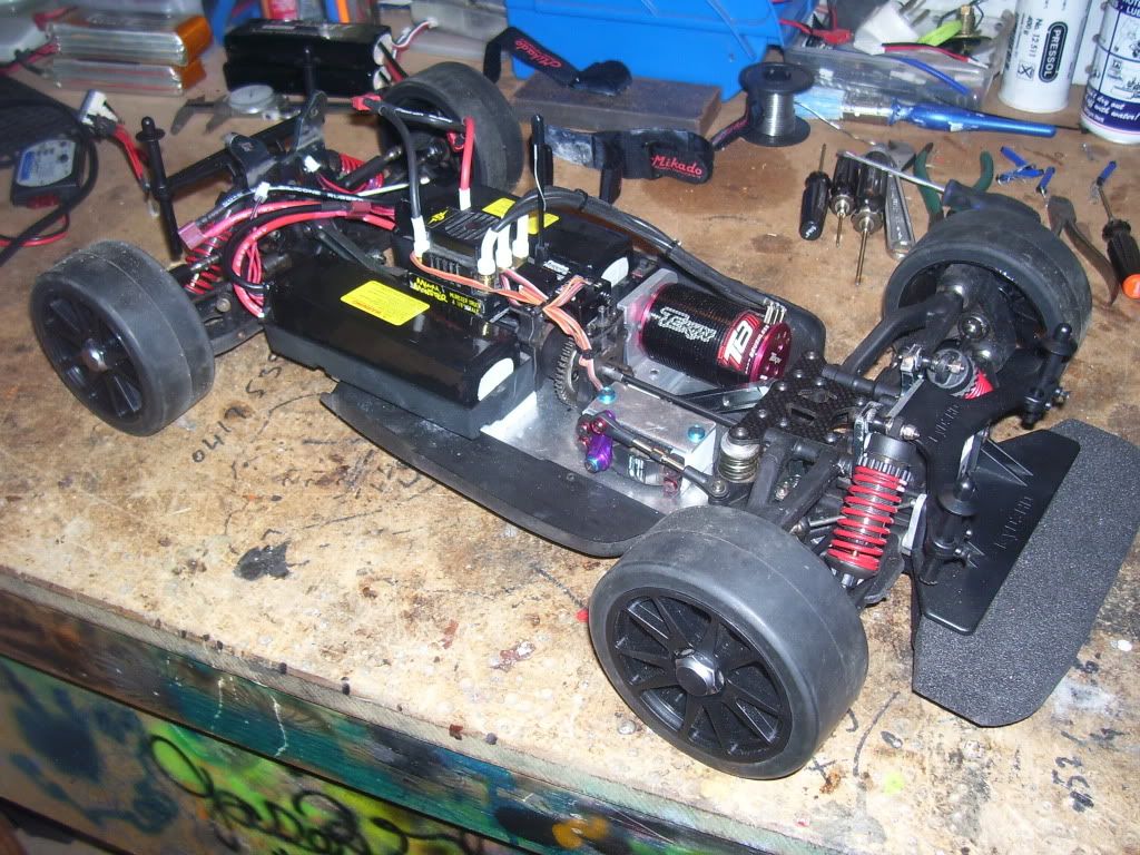

Hey Jas ,good to see you got that going...........this is what happen to my Mugen MBX5R buggy when I converted it to a 1/8 drifter ..I went all the way....

Oh no! You sold the beast Jas? Your mate doesn't want to sell it, does he? I love the way you built that thing? Wanted to build one my self but never got around to doing it. Let me know if your mate wants to sell it.

Nah ...sold it to a mate,he now lives in queensland,it was fun on 6s too...scary fast!!!!!
the longer wheelbase will make it easier,I got some 300,000wt diff fliud if you want it ,I used it in all three diffs.

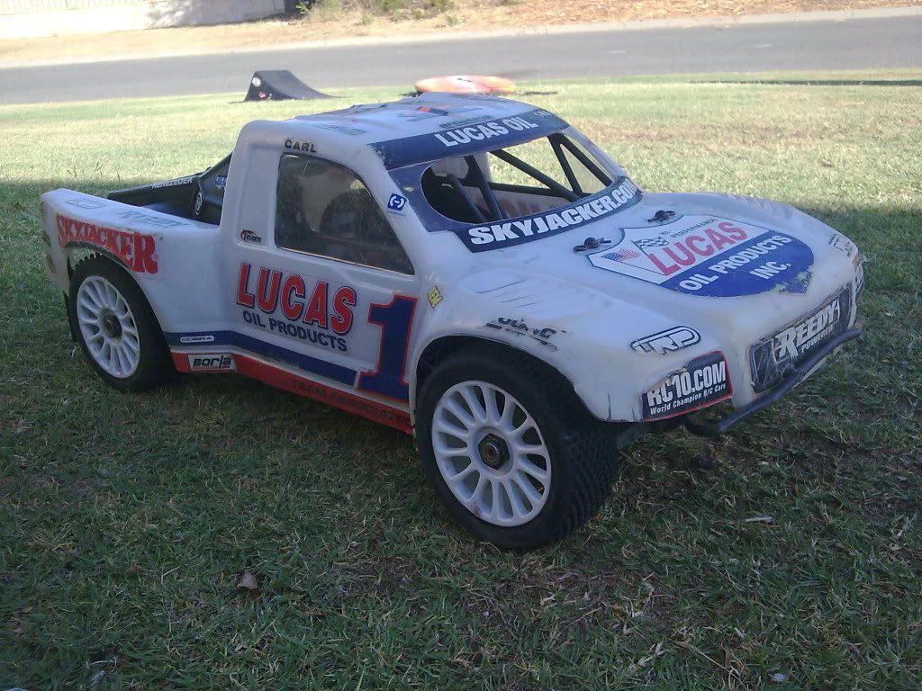

Previously buggies, sc trucks and 1/10 didn't interest me that much because of the low clearance. I got it mainly to run outside my house. I'm glad I got a buggy, it seems like a versatile platform.
BTW is that my ramp in the background?

yep.. still got it ,my son uses it alot,cheers mate.....you'll have to bring the buggy next time you come up racing ,you'll find it easier than the truggy as long as you don't over power it...lol
