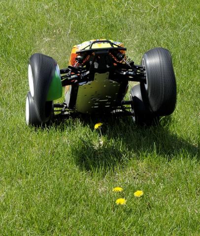

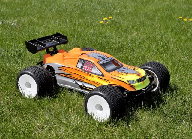

I finally had a chance to take the Muggy out for a spin yesterday. Apparently 50K in the center diff isn't enough. (See pics)
On 4s it was fun and on 6s...well....time to glue the front tires on again. If I hit WOT at any speed it would just lift the front end and blow the tires off.
I'm going to try 30K in the front diff and maybe add some preload to the rear shocks. I'm hope to try and keep the front end down.

excuse me sir (boy this is embarrassing...) but your foams are showing!

If I could go back in time I definitly would have used gorilla tape on the wheels. That would have been a great idea. I already glued them. I may try beadlocks for the next set and I will use tape.

honestly if 50k isnt enuff then maybe you need to look at a smart diff, i have one in my muggy and its holding up great aginst the 1717

Might I suggest some Gorilla Tape before you reglue the tires.
