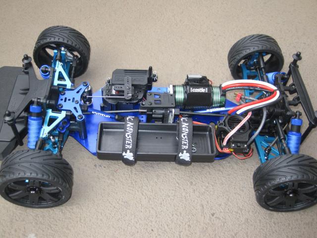

Okay guys I promised pics of the new beast so here it is!!
Parts used for conversion:
RCM Kyosho motor mount
Kyosho single speed center diff
Mamba monster ESC
Castle/Neu 1520 1y 1600kv motor
RCM 14t mod 1 pinion
Kyosho Inferno VE receiver box & servo tray
RCM Inferno GT2 battery box
Aluminum arms
Team Sweep black wheels
Ofna on-road tires
Kyosho front & rear torque rods
Scanner RC 9764MG high torque servo
Spektrum RS300 2.4 GHz receiver
Spektrum DX3s TX
So what do you guys think? Now let's see how fast this beast goes!!
Mamba monster ESC
Aluminum arms
Ofna on-road tires
Spektrum DX3s TX
How do you like those tires? Are they belted?
IGT_7x
IGT_7x's Avatar
Posts: 55
Join Date: Mar 2009
Location: San Diego, CA
01.08.2011, 06:28 PM
Actually I haven't tested them yet but it looks like they're good. No they're not the belted kind but I used the duct tape method to reinforce them.
