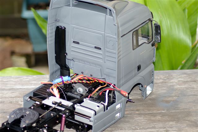

Gday,

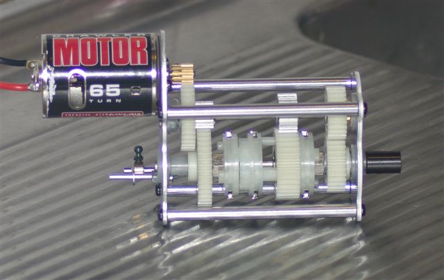

I've been running the Axial AE-2 esc in my Tamiya MAN truck for approx 9 months with the C/C's 10 amp ext bec. I removed the esc from my Honcho as I changed it to brushless. The truck runs a 3s lipo with a 65t cralwer motor through a 3 speed shifting box.
I asked the same question on rccrawler and alot of the guys were doing it.
Pete
Axial link - http://www.axialracing.com/blog_posts/787000000
They say it is fine to run 3s with the CC bec.

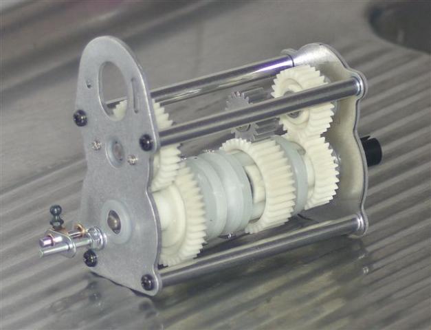

Truck gears:
Low gear - 1:32.49 (1)
2nd gear - 1:17.66 (2)
Top gear - 1:10.66 (3)
10T motor pinion, 65T brushed can, 3s lipo (3000MaH) & the AE-2 with cc 10 bec.

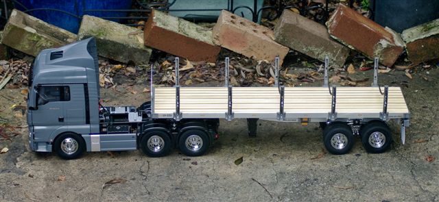

With the trailer, I haul 10kg, (2 x 6 packs beer + 2 longnecks). Coopers. I walk behind it with the DX3C & change all 3 gears on the fly on the footpath.
When I get to the main road, all the traffic is stuck in gridlock. Trucks, buses, cars etc. Via footpath, I drive my truck to the bottlo, inside the bottlo, load my truck, drive to counter and pay for beers.
Driving it home, most truck drivers blast horn or yell so they can take a shot. Car drivers stuck in traffic ignore me & think I'm an idiot, fool people thinking they own the footpath mutter obscenities at me, mums & prams stop due to jnr wanting a galk at the truck. I laugh mate at all of this. Such the joy of a Tractor truck.
I suppose this is my story to the AE2 esc on 3s with the cc bec properly used.

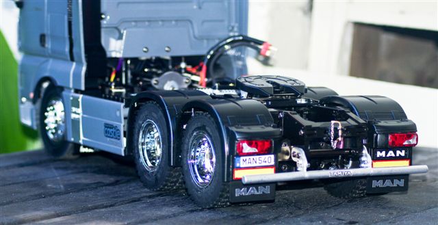

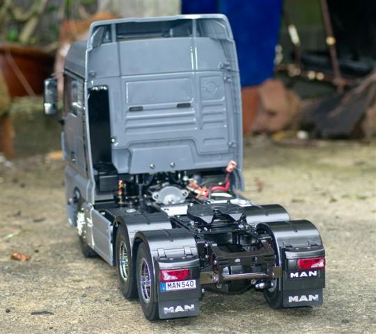

hooppjs Thank you for the write up! I wanted to ask you about the truck. Add some more photos if you have them.
Pretty funny story too. I'm glad you laugh them off and enjoy your truck
Originally Posted by brainanator View Post
ha, that's funny hooppjs! Sounds like something I would do :)
No worries fella's, thanks. I hope Bondonutz doesn't mind. I assume your all mates by the way you speak to each other.
Tamiya trucks are sweet. Good break from the round & round fast stuff.
Pete
