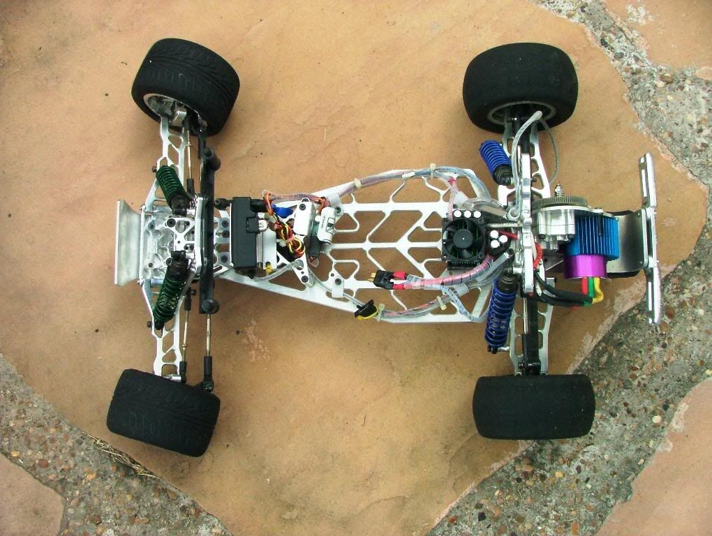

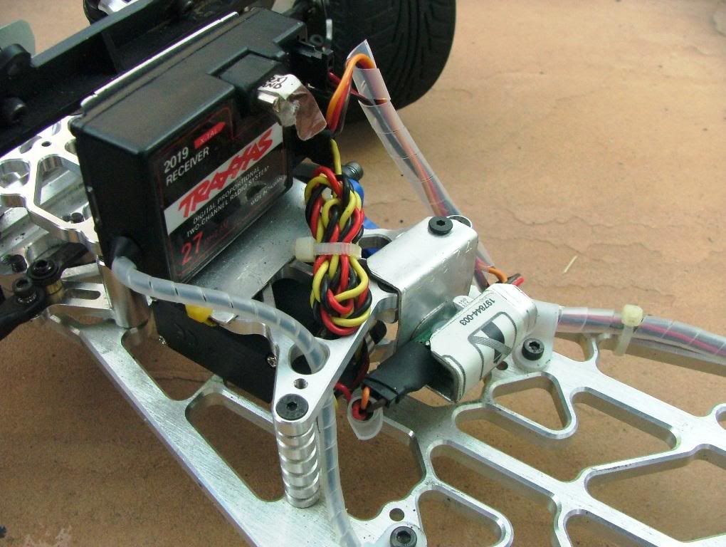

I had purchased a Park BEC from Dimension Engineering to run with my Mamba. I am running 9.9 and 13.2 volts and felt like the mamba linear BEC couldn't take it very well. The mamba ESC is a bit cooler now with the internal BEC disabled. Used it at today's dragrace and had no hiccups. It's installed right behind the Servo.
