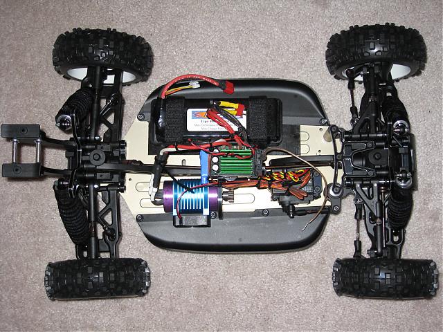

Just a quick pick right now in case your curious.
